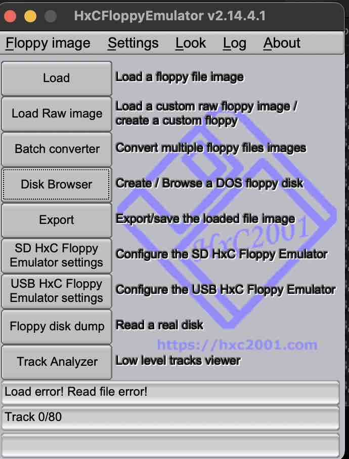

Ok thanks so much for the help! so i put the sp1200 HFE's on the sd card and in the hxc software loaded the "floppy file image" and it seems to have loaded but im not sure how to now put sounds on it? attaching a photo to show how it looks.
and wow - only 560KB?? how on earth did people put kits on floppys? or did they just sample everything in and build kits that way? im looking at my sounds and most of them are around 300kb so it doesnt really seem possible to even get a group of sounds on a floppy image. maybe im misunderstanding how these were used.

Re: New to HxC and am having trouble understanding a couple things

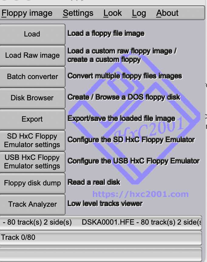

sooo i got a little further but when i try to load a sp1200 hfe file from that link i get the error in this picture

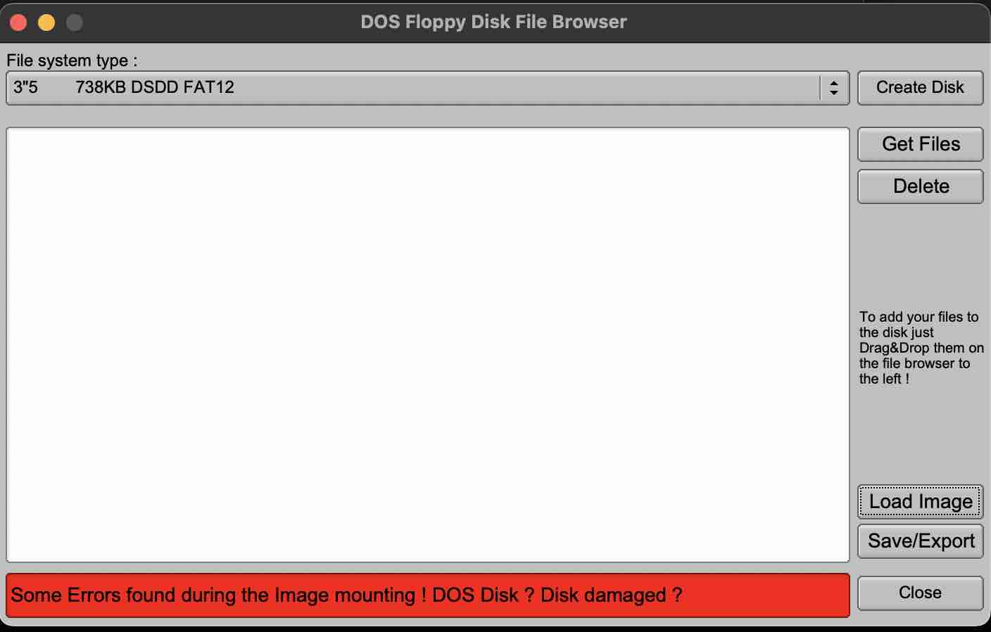

when i try doing it the other way i dont see the error when i load the hfe file but i see the error when i try to add music files to the disk as seen below.
please someone let me know what i am doing wrong! thanks so much.
- screenshot 2.jpg (53.19 KiB) Viewed 50613 times
So
since i had bought the sp and hxc off someone else with an sd card already set up i wondered if it was formatted on windows and thats where i was having issues.
So i formatted a new SD to be fat32
put an indexed .CFG file at the root
updated to the newest firmware (which i think worked)
Put the .HFE files that you told me to put on the SD on it
Everything works. The issue i am still having is that
When i load the .HFE files i downloaded into the software, i get that file error.
If i try and create a new disk image, it seems to work but when that file goes on the SP, the SP cant read it.
the file system type im creating with is the default which is 3"5 720KB DSDD FAT12. that could be where im going wrong but i just dont understand that part and left it alone.
It seems like an issue specifically with the HXC software either the firmware is too new for these files or i dont have the settings right.
I also have the HFE File Interfacemode settings to auto which picked Emu Shugart. I also left this alone because since the SP is emu it seems correct to me.
Let me know what you think!
Thanks so much
SP1200 doesn't use the DOS / Standard floppy format, that's why you can't edit/add files to the image with the hxc tool.
