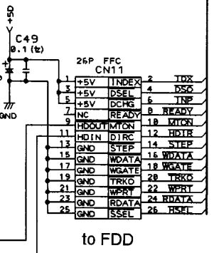

In the service manual for the VL1-m, it shows the pinout of the 26 pin cable (it's a low-res scan of a technical drawing -- see attached). There is a disk change pin. Unfortunately, I don't know the exact pinout mappings of the adapter I purchased (it clearly does pin mapping as you can see some of the traces on the PCB, but it's also clearly a multi-layer board as some of the traces go in and come out elsewhere).

What have you wired to the Yamaha pin 6 (DCHG, INP) signal ?

I purchased a multi meter so I could map out all the pins on the adapter from floppyemulator.com. It looks like pin 6 is mapped to pin 4 on the 34-pin connector. I have put all the mappings in a Google Sheet, available to view here: https://docs.google.com/spreadsheets/d/ ... sp=sharing
