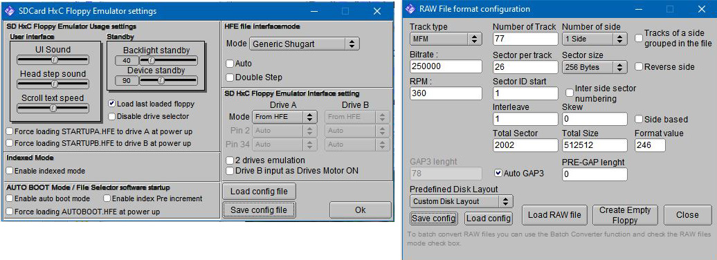

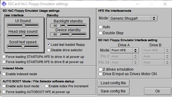

I have used the HxC software on my Windows PC to edit HxC files in an attempt to do this. I used the SD HxC Floppy Emulator Settings button to configure this as shown below left and save the HXCSDFE.CFG file to the SD Card. I also used the RAW File Format Configuration screen (below right) to create an SSSD.FPF config file and an EmptyFloppy.HFE file and copied these to the SD Card.

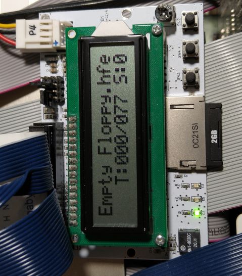

When I power up the computer, the HxC SD Card Access lights up and the display is as shown in the photo. When I try to access the Floppy Emulator as C: drive (DIR C: or STAT C:) the Floppy access LED lights up but nothing else happens and I have to Reset the computer.
That's where I am right now. I am not clear on the relationship between the two configuration screens above so it is very likely that I have not configured the SD Card properly. Any pointers in getting that right are appreciated.

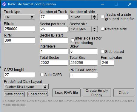

I fiddled with the floppy configuration parameters and eventually came up with a variant that the CP/M OS didn't barf on. Using the Generic Shugart mode and basic single density parameters for an 8" floppy I created an Empty Floppy HFE file and copied it to the HxC SD Card (see photos). I made sure the Empty Floppy was selected on the HxC screen and then tested.

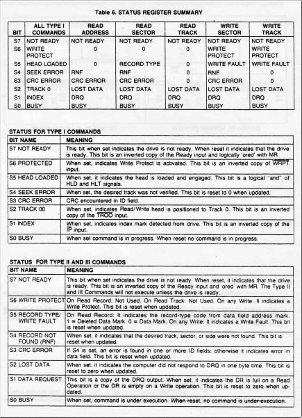

INIT ERROR: DRIVE C; SIDE 00; TRACK 00; SECTOR 1A; STATUS-06
I am not sure what the error code means but I have attached the 1793 Status Register Summary:

Are you sure about the format specifications ? 128 bytes 26 sectors FM sectors can't fit on a 300RPM (200ms) or 360RPM (166ms)disk at 250kbits per seconds (data + clock bits)
you can inspect the disk/track state in the "track analyzer" windows
Please try to format / init all the images i have just sent to you and send me back them.
