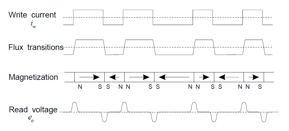

Low level Floppy disk data encoding
The data recorded on the magnetic support is done by changing the magnetic polarization with different time intervals.
At reading the head coil generate a voltage peak at each polarization change (also called "flux reversal" / "flux transition").
This voltage is then amplified and "reshaped" by the drive and sent to the machine floppy controller on one wire.

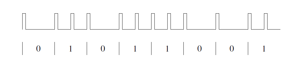

There are different data encoding schemes used. The most common ones are FM (Frequency Modulation) and MFM (Modified Frequency Modulation).
FM (Frequency Modulation) scheme (used on "Single density / SD" disks) :
For each data bit there are 2 pulses : One clock pulse and one data pulse. The data pulse is only present if you encode an '1'. '0' is encoded by a space.
You can see that there are 2 different pulses spacing with this encoding scheme.
With a 125Kbit/s data rate you will have 8uS and 4uS pulses intervals.

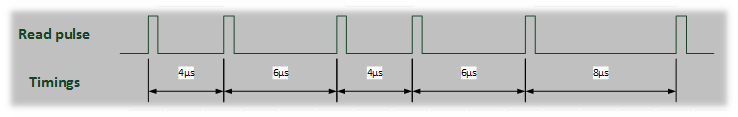

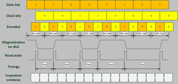

MFM (Modified Frequency Modulation) scheme (used on DD "Double density", HD, ED disks ) :
MFM Example.png (17.47 KiB) Viewed 18189 times
With this encoding scheme the clock pulses and data pulses are multiplexed. This allows to double the data density.
As you can see there are 3 different pulses intervals. For a DD disks you will have 4uS, 6uS and 8uS pulses intervals. With an HD disk this is 2uS, 3uS and 4uS...

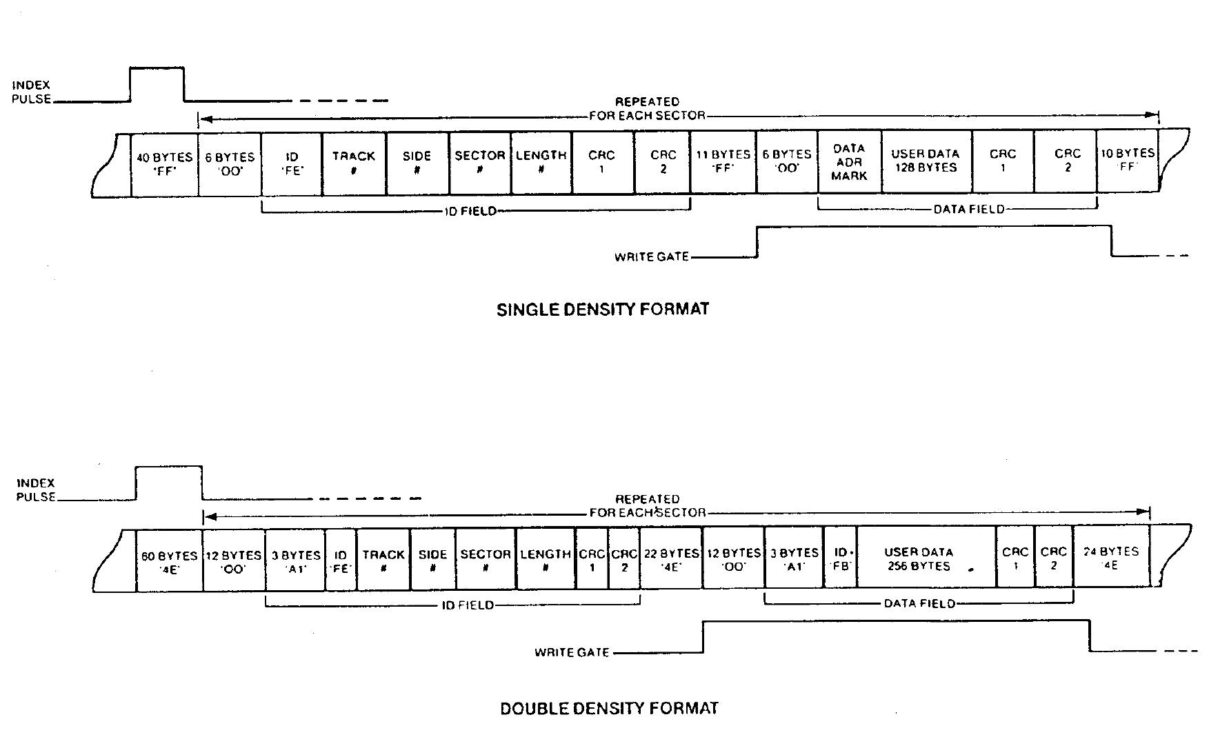

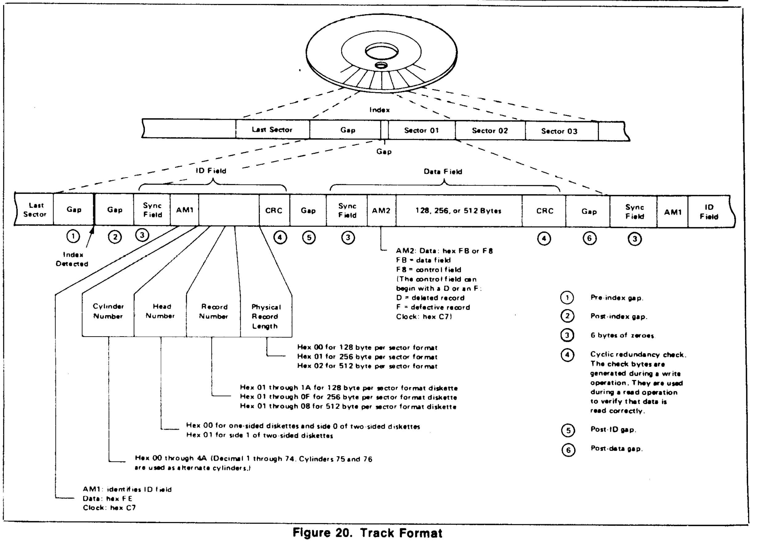

On top of this you need to define a sector format to be able to synchronize the floppy controller when reading and to get back the recorded user data.
There are many sector formats but the most commonly used is the ISO/IBM format.
Right now i will not go into the detail of each existing sector formats but they are generally composed by an header to identify the sector (note : some exceptions with the hard-sectored disks) and a data part. The sector integrity can be checked with a checksum or CRC.

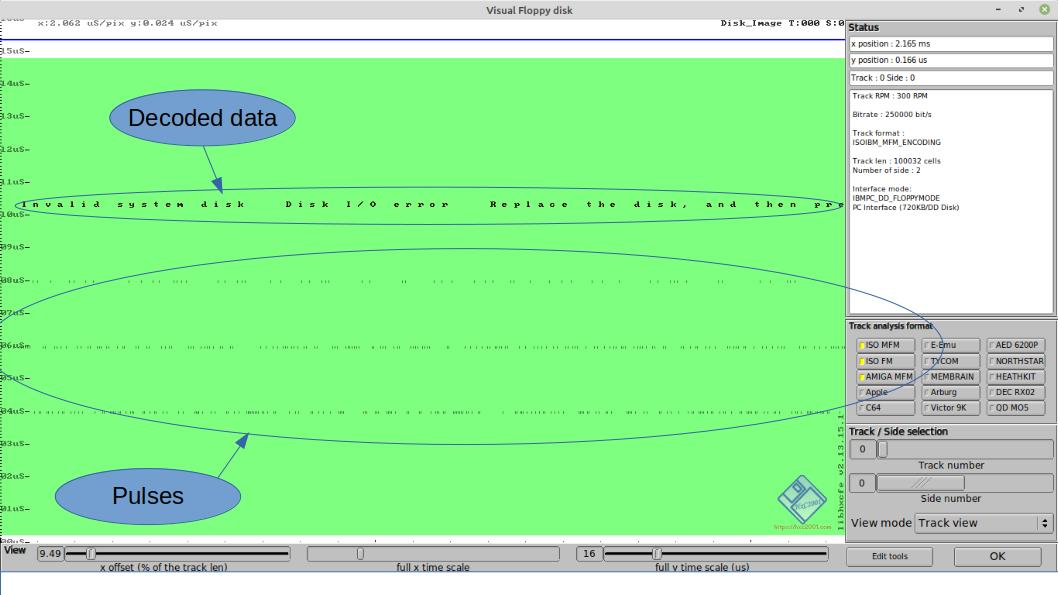

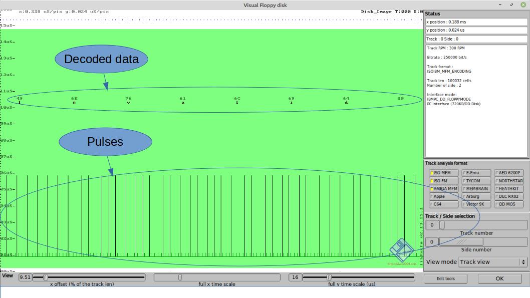

Now back to the HxC floppy emulator stream viewer and track viewer.
Both stream and track viewers show you the time interval between pulses on the track. The following example show you a standard MFM track. You can see the 4uS,6uS and 8uS pulses.
About the pulses here is a short reminder if you don't have read the previous post :
When reading a disk the drive is just sending these kind of pulses to the machine on one wire (the "Read" wire). The different time intervals between pulses is used to encode the data on the disk.
Please note that the track and stream viewer can show you the decoded data if you zoom enough one sector :
And in track view mode the way the pulses are drawn is changed when you increase the zoom level :

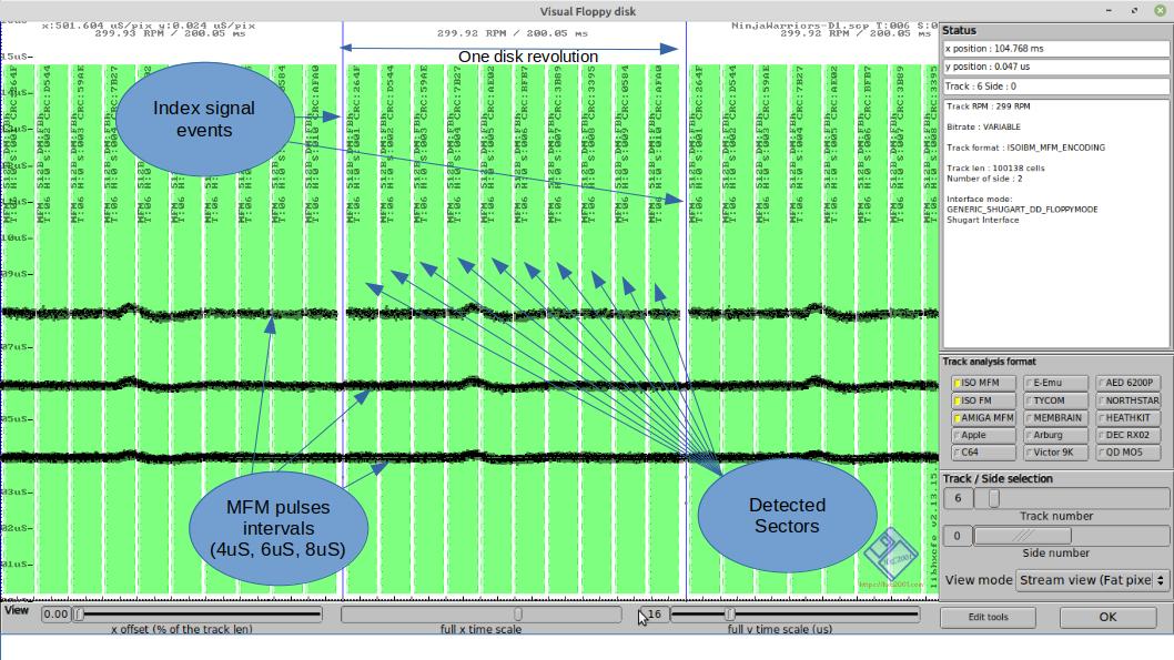

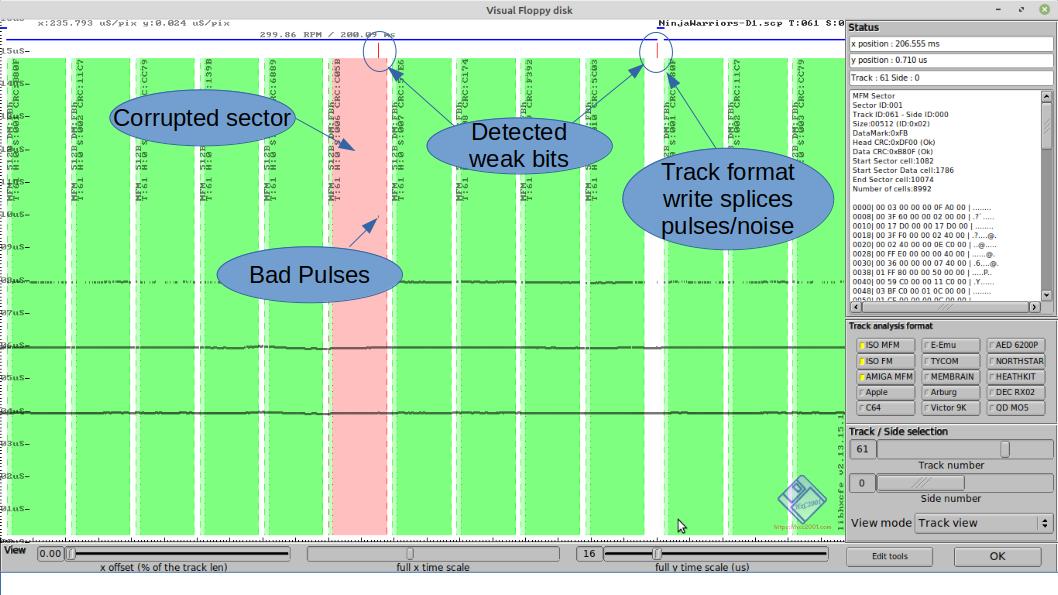

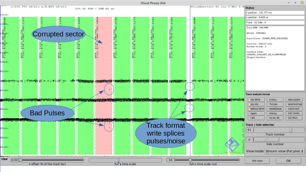

Re: Understanding the visual floppy display
One important point about the difference between the "Track viewer" and the "Stream viewer" in the HxC Floppy Emulator software :
The "Stream view" directly shows you the pulses as they are in the stream file. It shows you all the dumped revolutions. You can see all the noises captured during the dump in this mode. This view mode is only available with stream files. (stream files : hxcstream from Pauline, *.raw files from Kryoflux, *.scp files from SuperCard Pro, ....).
The "Track view" shows you the tracks after the stream data analysis done by the HxC Floppy Emulator software : There is only one revolution per track reconstructed by the analyzer from the stream, weakbits/flakey bits are located on the track. The pulses time intervals and jitter noises are filtered and pulses are normalized into cells. This view mode is available with all file image supported by the HxC Floppy Emulator software.
These views allow to check the dump quality and the state of the disk. You can see the signal jitter, the surface defects, the write splices, the disk rotation stability and the variable bitrate and weakbits protections.
