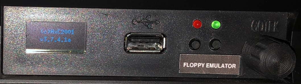

I've purchased 4x AmigaStore.eu Goteks with HxC firmware over the past two years.
My very first one is running 3.7.4.1a. it reads and writes ADF files perfectly.
YAY! The experience was great, so I bought more.
My later HxC Goteks are running 4.0.5.3a and they read ADFs, but only pretend to write to the ADF.
The drive acts like it's writing, but nothing is written to the ADF file, changes are simply lost.
