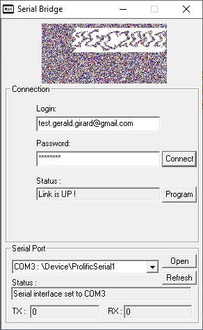

I can't update my bootloader.
With my email address and my password I am connected.

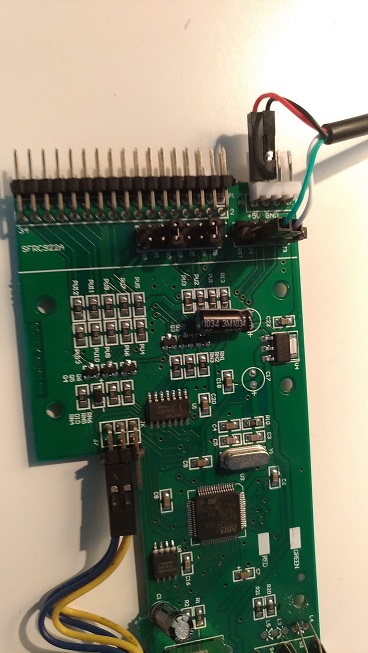

The software sees the serial port well, the connection is I think correctly done on the gotek.
It refuses to program itself, Rx and Tx remain at zero?
Do you have an idea ?

Did You cross Rx and Tx wire?
Procedure to Flash the device :
1) Set the BOOT0 signal to the VCC3V3 on the device. (Add a connection between "J3" and the VCC3V3 pin. See below).
2) Connect your serial adapter to the device and to the PC. (GND,RX,TX,+5V) Note 1: To power the device, you can use a external +5V source or the +5V coming from your USB adapter. Note 2: Cross connect your serial adapter to the device : TX wire to the RX pin, RX wire to the TX pin.
https://hxc2001.com/docs/gotek-floppy-e ... ation.html
