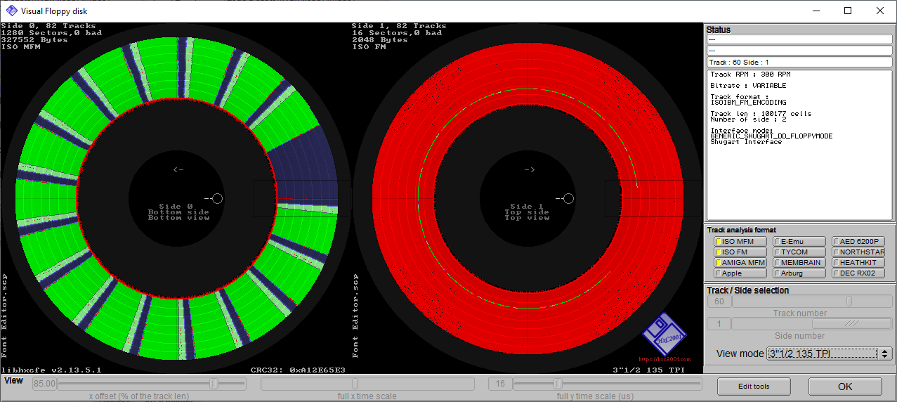

The following is a .scp image of the original disk. Please note that Side 1 only has track 60; that's ok, it's just the way the disk is (some sort of copy protection). Everything seems in order.

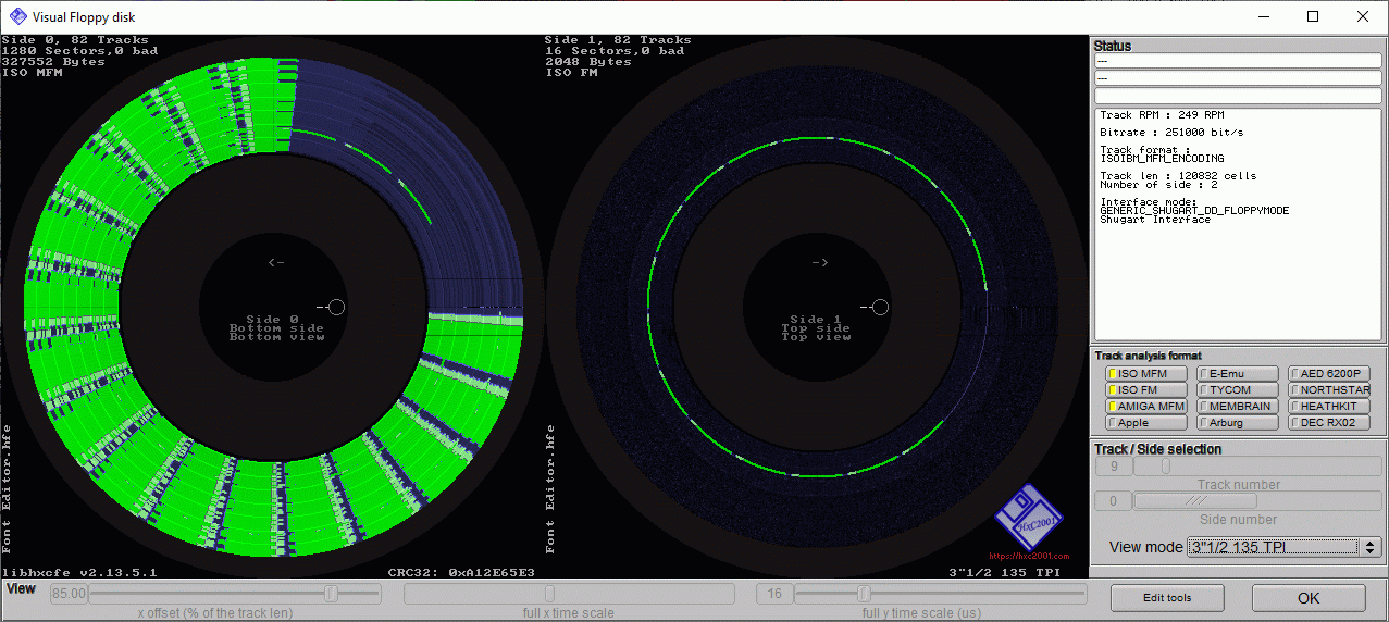

The next image is the .hfe produced by HxC Floppy Emulator when I converted the previous .scp. Note how the sectors on side 0 have been compressed spatially, all but those on track 60 which have retained more or less the same angular span as in the .scp. Is it a coincidence that track 60 is the only one that has data on both sides?
When I try to write the HFE to disk using the Greaseweazle, track 19 of the disk ends up totally corrupted. Any ideas what's going on here? I can provide files if needed.

Can you please take a look at tracks 19 and 60 of the HFE image? Track 60 is the only one that retained the same layout as in the .scp image, while track 19 seems to have been compressed more than the others: the angular span of each sector is half that of the other tracks.
