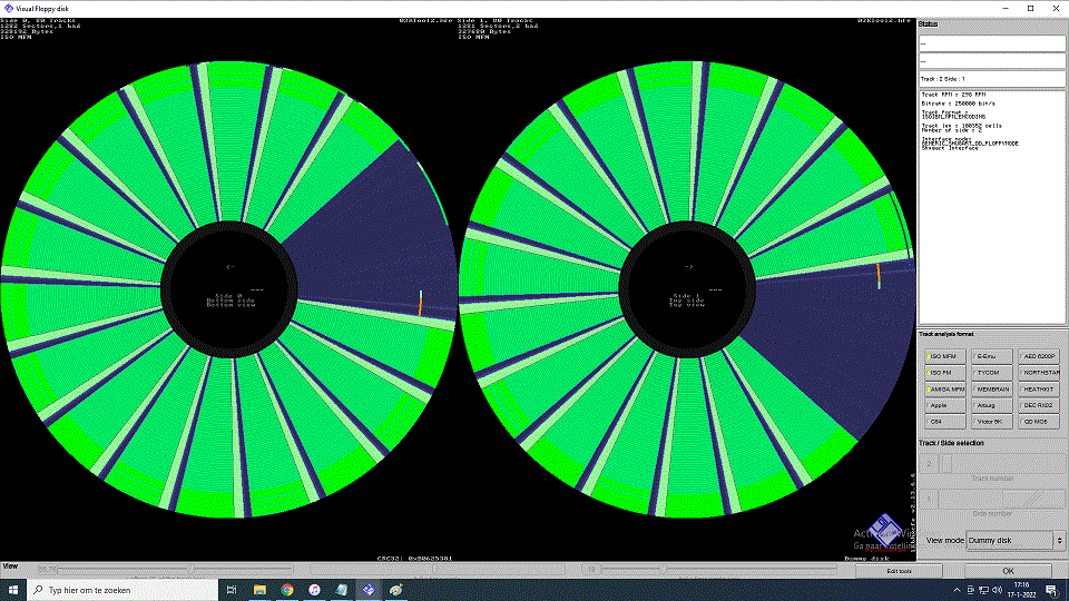

I am working on a project for making machines more sustainable. I want to replace the floppydrive with an emulator. I bought a Gotek for testing. Maybe is a HxC better for future use (Since it is in industry)

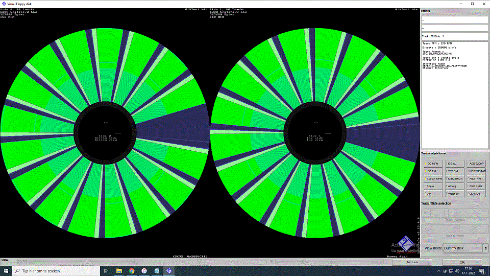

I managed to format an empty drive with my OS9 PLC. I only get continuesly error 247 (SEEK ERROR - physical seek to non-existant sector.) when I want to make a backup of an existing floppy. Today I found a laptop with floppy drive. I was be able to dump the floppy to an image. The PLC can run correct from the emulated floppy. When I want to format the working floppy and back it up again via OS9 I get the seek error again.

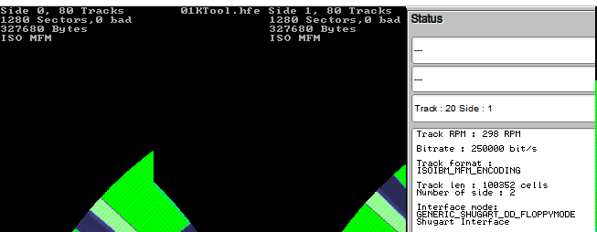

When I compared both images with the Track Analyzer I can see what the error is. Does someone know which settings I have to adjust so I get the right layout of the images?
Info:
Working image
New formated but not working image
Thanks in advance!
