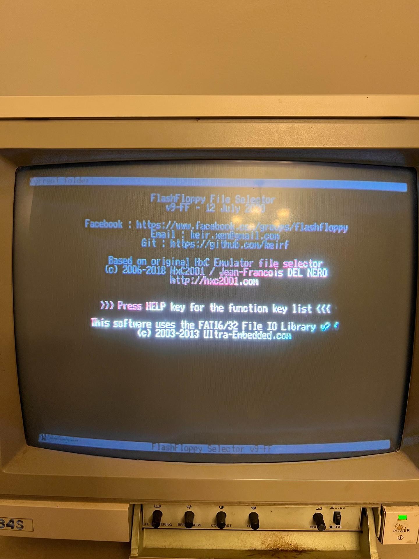

I formatted to fat32 as required and put on the relevant software that I could find on the gotek site etc. And also the games that I still have on disk but obviously with no drive I can not play.

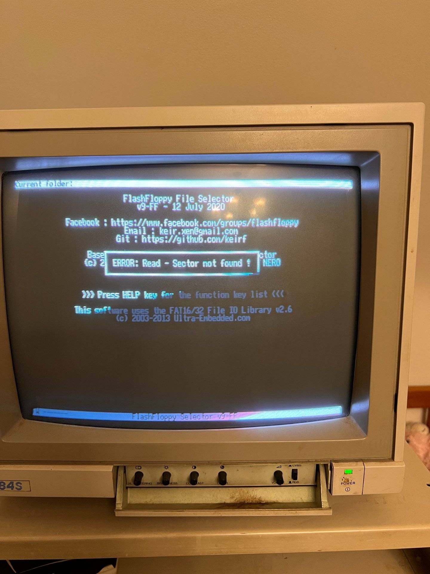

The problem is that with the usb drive inserted I get what I assume to be the standard screen for a few seconds and then I get this "Error: Read - Sector not found!".
I am normally OK with researching this stuff if I at least have an error number or something, but I am really struggling with the ambiguity of the error message.
Any ideas anyone? I do not mind buying a new usb drive if I need to, or playing about with the files on there, anything really, I just want to get this thing working again!
All the very best to you all, happy 2022!
Re: GoTEK - Error that I can not work out
I can't provide you any support since you don't have the HxC firmware installed on this unit.
To get and install the firmware : https://hxc2001.com/store/
