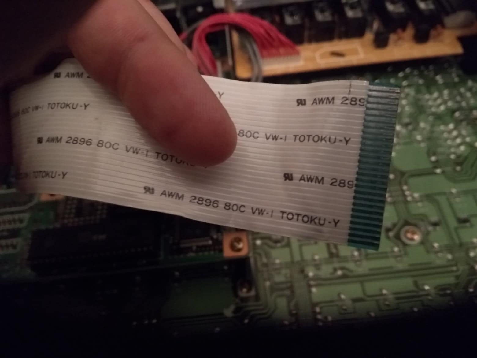

I wanted to test a Gotek flashed with HxC in a Korg I5M, which I had laying around.
Korg I5M needs a 34 to 26 pin ribbon cable adapter, which I ordered from here:
https://www.ebay.de/itm/304011493903
my OLED screen tells me that the cable is reversed, but if I turn the adapter, then the device and Floppy emulator stays off.
Any ideas?

What is the exact MCU model used in this Gotek ?
The ribbon message appears if the Write gates (24) and Step (20) signals are low/connected to the VSS/GND.

We are talking a SFRKC30.AT2 model.
I think I found the issue, see the 2 cracks on the Ribbon Cable, I dont know what these signal represent, but i guess that is not a good sign!
I need to find a replacement for a AWN 2896 26-pin Flat Flexible Cable, which seems not very easy. Do you think a AWM 20264 can substitute?

Re: Korg I5M and HxC
I need the exact MCU reference : A same pcb reference can now share many MCU references (and clones/fake unfortunately ...)
Which firmware version are you using ?

Jeff wrote: Fri Oct 29, 2021 10:31 pm I need the exact MCU reference : A same pcb reference can now share many MCU references (and clones/fake unfortunately ...)
This is one of the expensive ones with STM32F105 and firmware version 3.5.2.5a
Concerning my question above, would replacing the AWN 2896 with a AWM 20264 be sufficient? [as this could be the root cause to the issue]

Wait... This is an AT2 board with a QFN STM32F105 version ??? In this case this is the root cause of the issue, i need to modify the firmware to support this new board<>mcu combination...
