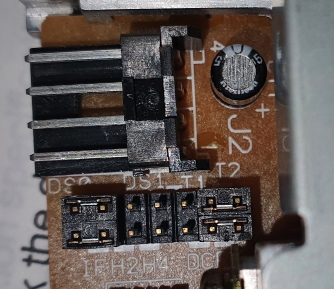

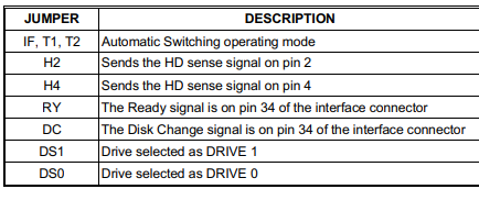

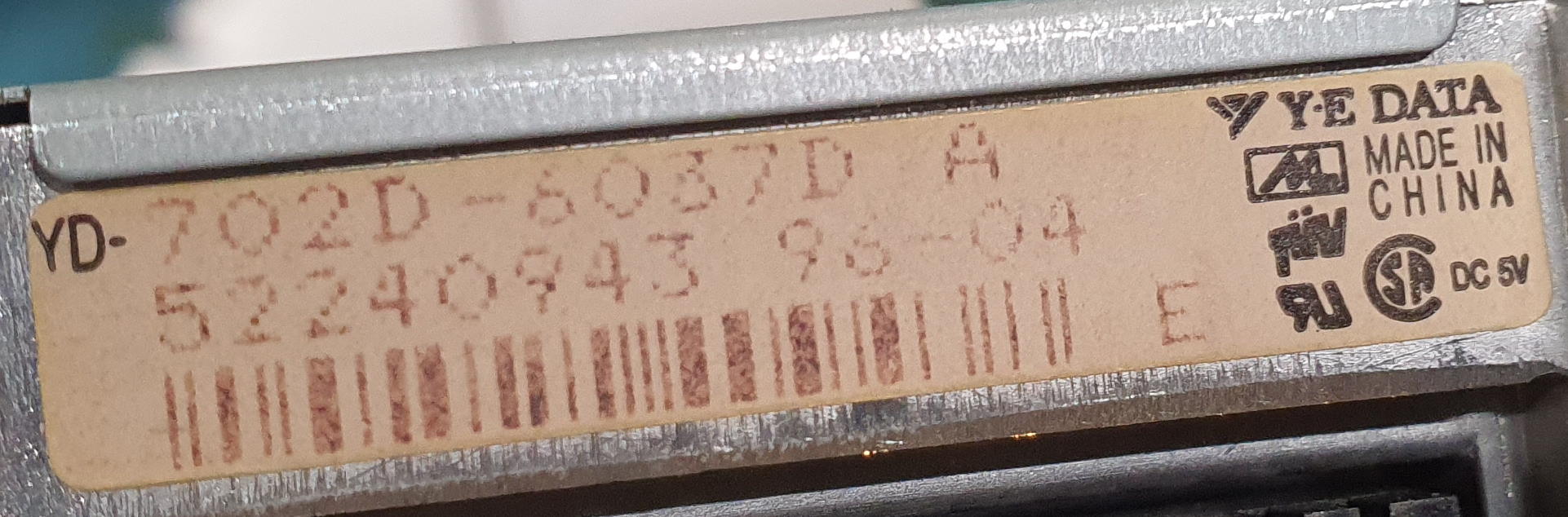

if this helps, I have attatched the settings of the original floppy and it's make.
What each of the jumpers do if that helps:
Here you can see DS0 is on, IF is on, RY is on, and T2 is on.
IF plus T2 is automatic switching mode
DS0 as we know is drive select 0
RY is the ready signal on Pin 34.
