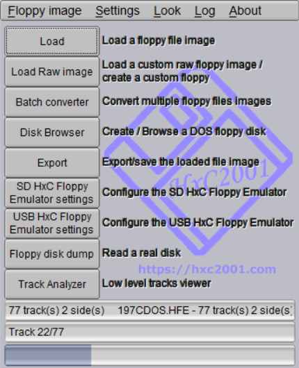

a) Note all .HFE files work fine on the SD Card HxC
b) HxCFloppEmulator.exe is at v2.5.6.6 sitting on a Windows 10 with all fixes.
c) I can load any valid .HFE without error, it says right number of tracks and sides on bottom scrolling display

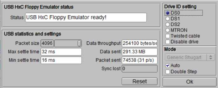

ALSO I note that in the USB HxC Floppy Emulator settings panel, unless the Packet size is set away from default 1664 to 4096 then I get Sync Lost errors. But with it set at 4096 I dont get a single /Sync Lost/ error. But the USB unit STILL DOES NOT WORK for any write operation

b) With an 8" diskette image loaded basically NOTHING WORKS
Diskette cannot be seeked.
02 usb status.jpg (21.57 KiB) Viewed 7298 times
01 8 inch image.jpg (27.59 KiB) Viewed 7298 times

CAN I EMPHASISE that I take a working SD HxC system, using the same cable and .HFE images, disconnect the SD unit and connect the USB unit. Load the same .HFE on my connected workstation, check the USB status screen says okay , with no dropouts, then perform the test.
the SD HxC unit works fine (with images on an SD card)
the USB HxC unit does not work fine as above
Since there is good read activity on the USB HxC unit with 5.25 inch diskette I can be sure that the cable is 34 pin floppy ribbon is the correct way around etc.
The SD Unit shares its cable with 2 other devices so to be paranoid sure I took a separate Floppy cable and connected ONLY that from Cromemco Disk controller to USB HxC unit. To avoid any termination issues et al. Same result. 5.25 emulation works read only, 8 inch emulation totally and utterly fails.
