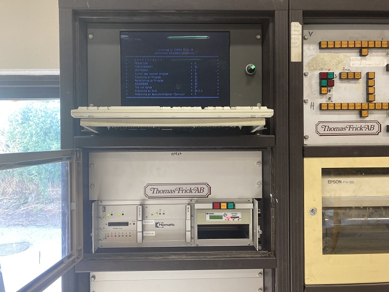

So here's an image for posterity with the disk drives replaced.
- HOMAG FLEX-computer for size&banding
- FLEX-system.jpg (153.75 KiB) Viewed 47227 times
