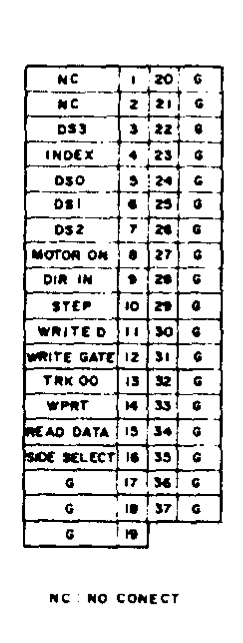

Here are the pinouts I am using from Gotek > 37 pin Sub
Pin 2 IDC - /DCD not connected
Pin 4 IDC - /DS3 not connected
Pin 6 IDC - /INUSE not connected
Pin 8 IDC - /INDEX goes to Pin 4 37pin D-SUB - /INDEX
Pin 10 IDC - /DS0 goes to Pin 8 37pin D-SUB - /MOTOR ON
Pin 12 IDC - /DS1 goes to Pin 6 37 pin D-SUB - /DS1
Pin 14 IDC - /DS2 goes to Pin 5 37 pin D-SUB - /DS0
Pin 16 IDC - /MTRON not connected.
Pin 18 - /DIR goes to Pin 9 - /DIR IN
Pin 20 - /STEP goes to Pin 10 - /STEP
Pin 22 - /WDATA goes to Pin 11 - /WRTE DATA
Pin 24 - /WGATE goes to Pin 12 - /WRITE GATE
Pin 26 - /TRK00 goes to Pin 13 - /TRK00
Pin 28 - /WPT goes to Pin 14 - /WPRT
Pin 30 - /RDATA goes to Pin 15 - /READ DATA
Pin 32 - /SIDE1 goes to Pin 16 - /SIDE SELECT
Pin 34 - /RDY not connected.

Re: HxC Gotek and Sharp Mz-80b
Why DS0 is connected to Motor ON ??
No ready signal
No ready signal
I have attached the pinouts for the MZ-80B card. If you have any suggestions then please let me now. I did not see a ready signal on the sharp end.
- Capture.PNG (33.03 KiB) Viewed 13601 times
This makes the activity light stay on as the Sharp tries to access the drive on request but it's still not loading the drive image. Feel we are getting closer though. Do you think we need a motor on connection?
EDIT: Never Mind. I connected Motor on and we are right back to seeking then returning to the main boot menu
