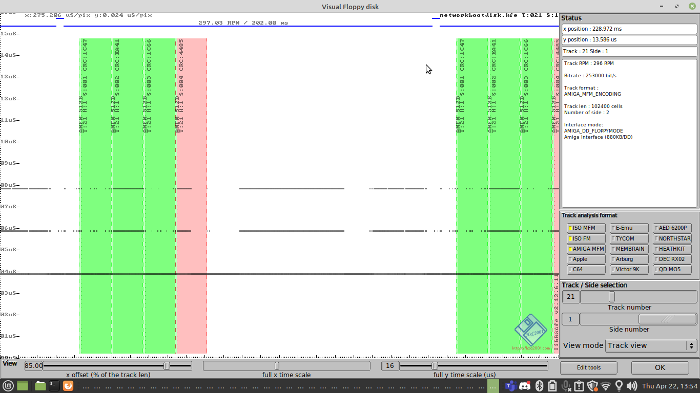

Re: HFE image write errors
Yes it appears that this Amiga is going nuts and is writing garbage to the disk... :
Screenshot at 2021-04-22 13-54-23.png (89.06 KiB) Viewed 66906 times
Have you disconnected the Hard disk before doing this test ?
Another point : Can you check the Amiga +5V voltage ?
