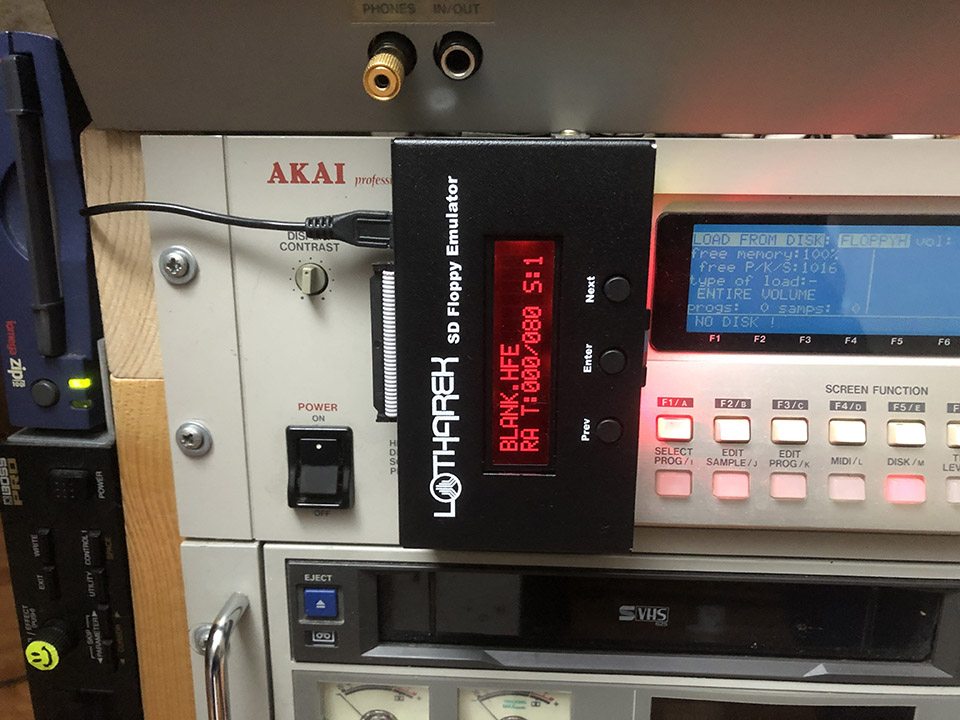

hey everybody
i am quite lost atm with the jumpers on Lotharek hxc sd max version
i tried to make things cheaper and got this version where i found no reference..
any clue would be very appreciated : -)
ps. i will post jumpers config as soon as i get them working

Re: LOTHAREK HXC SD MAX - AKAI S3000 JUMPERS
Reconnect the floppy ribbon to the other way.

Thank You.
(explanation : The permanent "RA" and "S:1" text on the second line indicate that the floppy ribbon is not connected properly : all the floppy signals are shorted to the VSS/ground)
