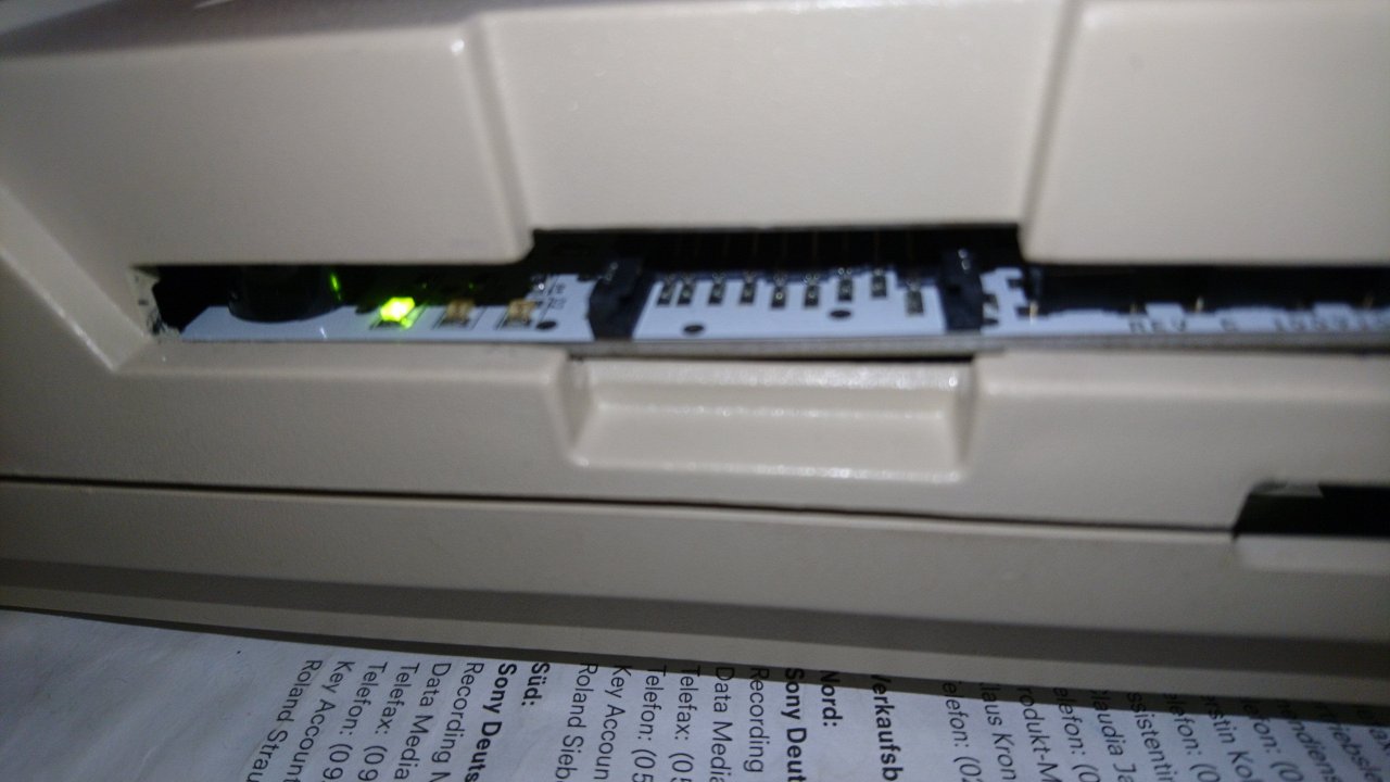

did not want to open a separate thread so I ask here briefly. The Drive LED on the Amiga and the red one on the HxC are now permanently on. But that's not right, is it?
Re: Problems with SD Card HxC Floppy Rev C
DonChiChi wrote: Tue Jan 12, 2021 10:53 pm did not want to open a separate thread so I ask here briefly. The Drive LED on the Amiga and the red one on the HxC are now permanently on. But that's not right, is it?
Effectively this doesn't sound "ok". Are you using an external case ?
Post by DonChiChi »
No external case.
DonChiChi wrote: Wed Feb 24, 2021 8:40 pm No external case.
Is the drive working ? This may be a problem in the Amiga itself...
