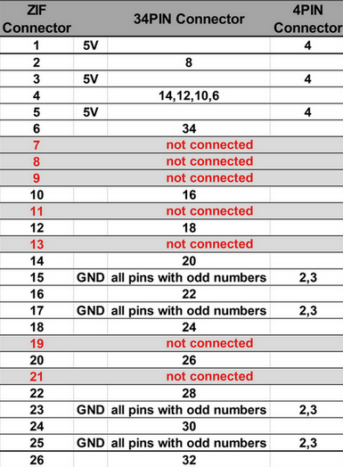

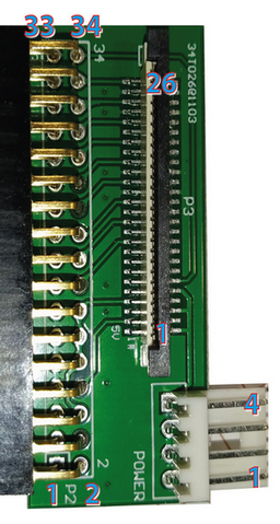

I've taken a picture of the adapter and tested the PIN-layout (see attachements). In fact several Pins from the ZIF are not routed to the 34 PIN connector.
Is there a schematics, how the 34 Pin connector should be connected to the 26 PIN ZIF or is there a general incompatibility and I need another PCB?

Re: ando aq6317b
See the page 16:
https://hxc2001.com/download/floppy_dri ... al_ENG.pdf
The pins 8,9 and 11 shouldn't be unconnected.
Try to set them at 0 or 5V.
