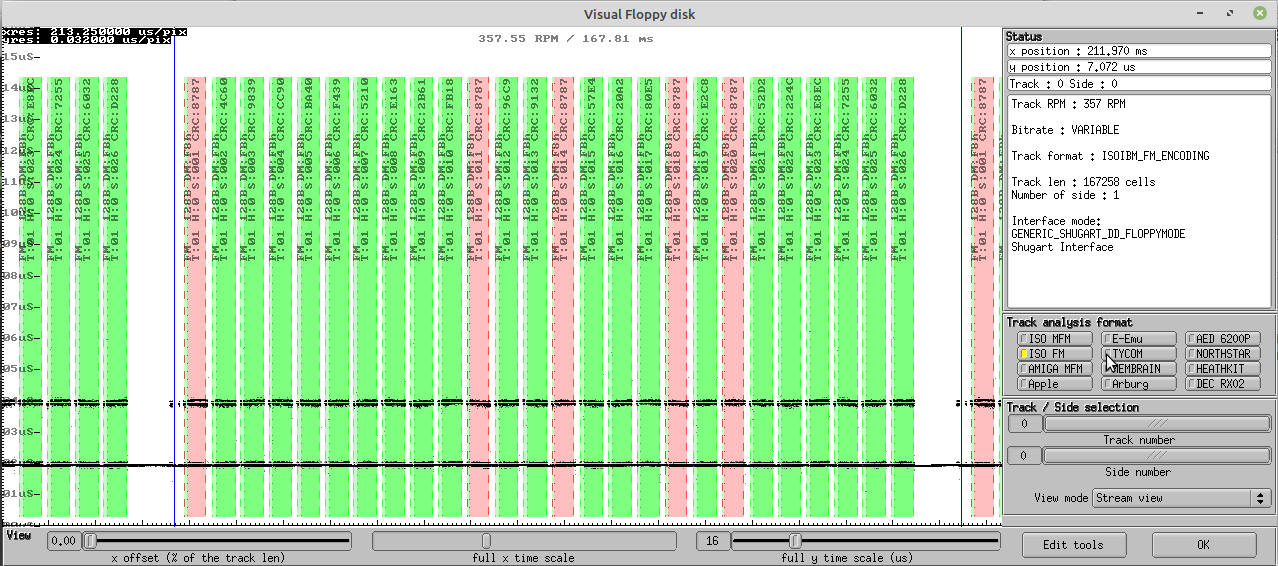

Re: Stream file conversion with hxcfe
I recommend you to use the latest version:
and also use the GUI :
Screenshot at 2020-10-15 22-26-43.png (43.47 KiB) Viewed 7713 times
The stream appears to be clean. I don't think that there is any physical damage.
Interesting point : The sectors with the bad CRC have the 0xF8 data mark which mean "deleted data mark".
So i think that this is not a bug but a feature ;) : I suspect that the machine write a partial sector with the 0xF8 data mark to "delete" the sector.
(Note : a .img can't store the data mark and crc state. I recommend you to use another format : hfe, imd,...)
