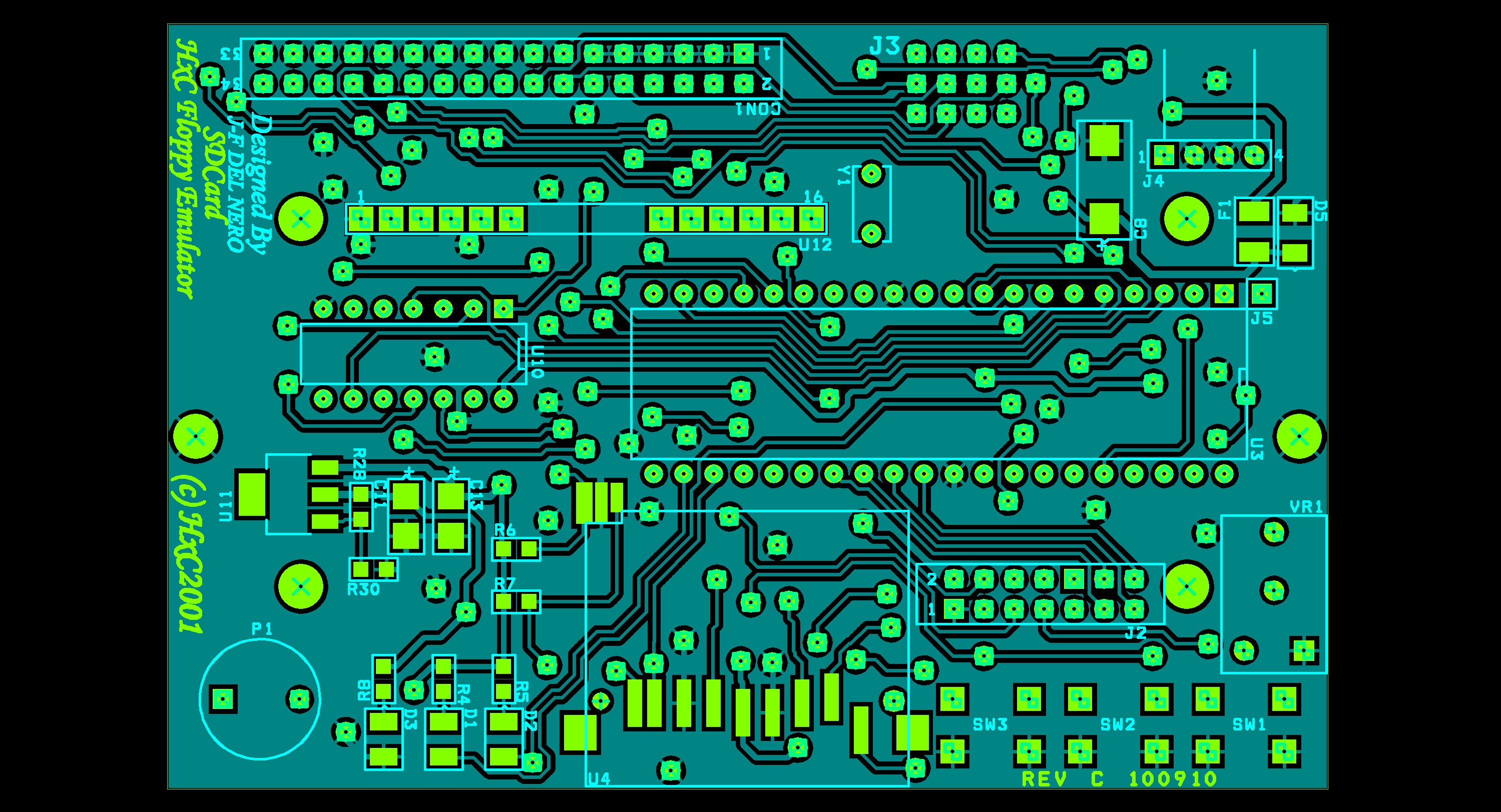

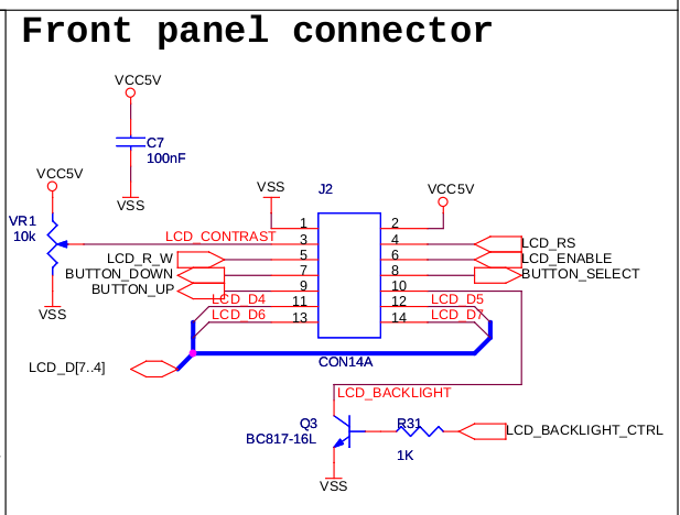

The Rev C have a connector on the pcb to connect the LCD and the buttons.
But you need to add/solder this connector since Lotharek doesn't mount it. (J2 / Front Panel connector)
See : https://hxc2001.com/download/floppy_dri ... Design.zip
EDIT : I see this PCB marking: "REV C 100910" -> This board design is ten years and 10 days old ! :D :shock: :D
