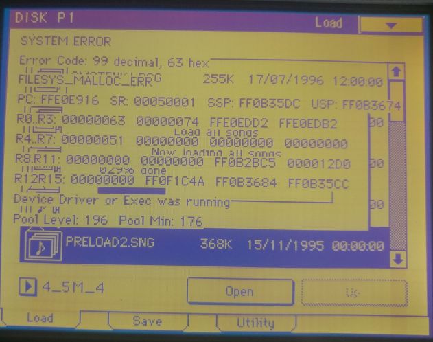

Tried also to use bigger partitions (4.5Mb) but apparently the Trinity doesn't like them...the directory shows all files (basically I copied the contents of 4 floppies in 1 partition...but only reads/loads the few on top (the first floppy) - if the files are outside the standard boundaries I get the error message shown in the picture and need to reboot the Trinity (pity).
Trinity error message when reading above floppy size...
Re: newby - old IMG not recognized
Ok thanks ! (i think i should make a list the machines supporting big/non standard floppy format).
