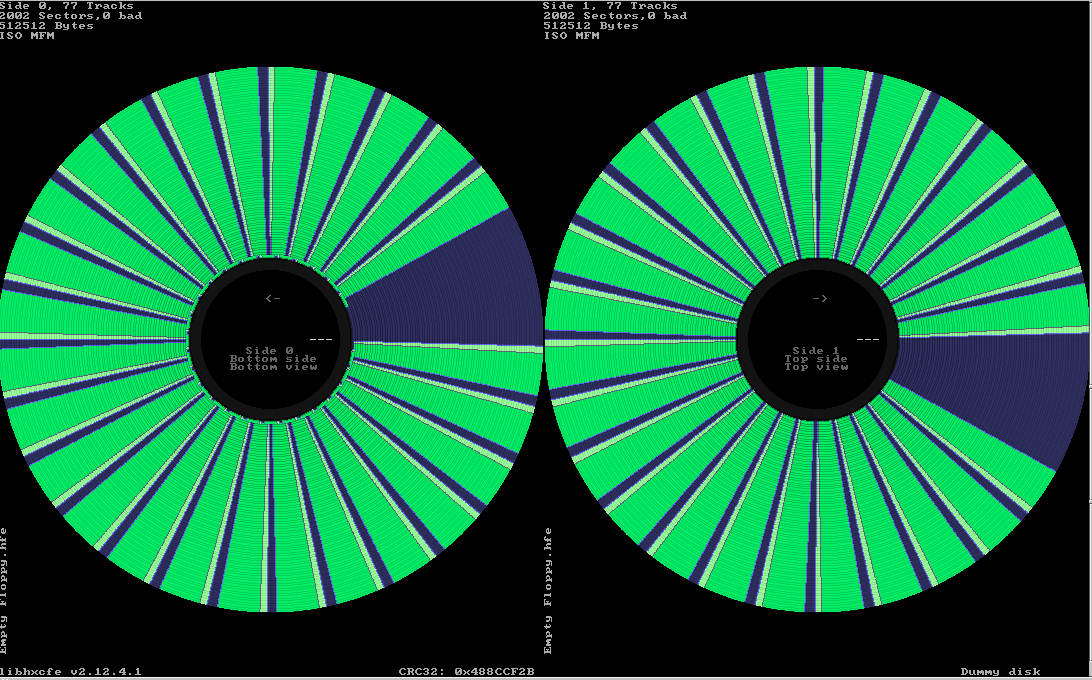

Well, frustratingly enough I decided to create a fresh HFE file to do the format in case there was some less-than-useful rubbish - and of course now I'm getting a different error message! I'm getting "Rotation Error" which as far as I can tell means that the M68 is choking on the data rate - I had it initially when trying different ones, and finally got rid of it.
So not sure how much use it is, but I've attached the HFE file after a format attempt.

Please retry with an image initially set with 0 sector. Here i can't tell what was formatted or not by the machine.
I see something at the side 0 last track. is the sord starting to format from the last track ?

I've created an image with no sectors defined, and tried a format in both Sord's FDOS and CP/M-68K - FDOS does count down from 76 to 0 while formatting, so I suspect they do start the format at the last track for some reason.

ok i see now.arjoll wrote: Sun Jun 07, 2020 12:46 am I've created an image with no sectors defined, and tried a format in both Sord's FDOS and CP/M-68K - FDOS does count down from 76 to 0 while formatting, so I suspect they do start the format at the last track for some reason.
i think that the sdcard is just too slow. Which sdcard are you using ? (which class?)
