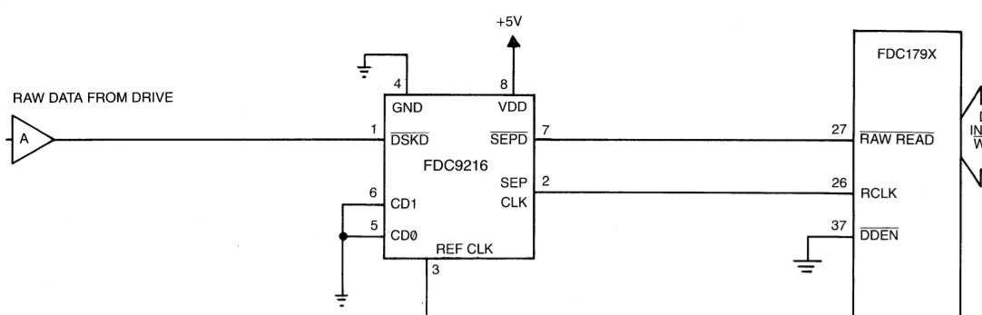

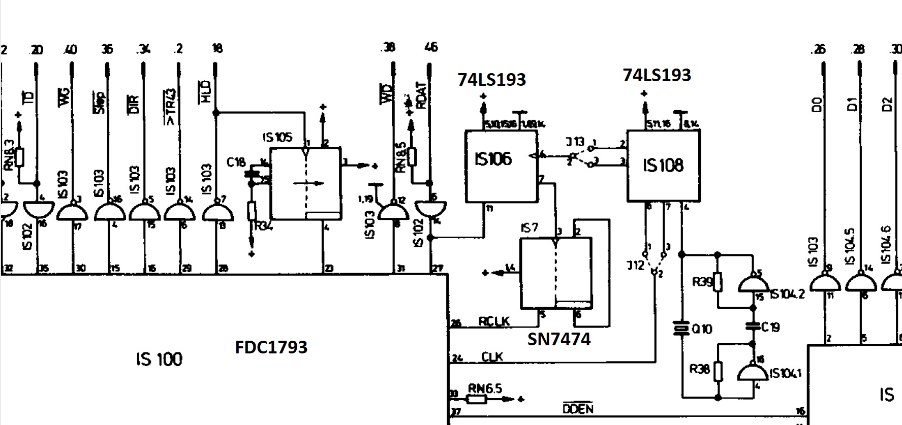

I discovered the difference between the two boards. (I attached 2 pictures)
The original Eltec 7.1 has minor modifications
Eltec 7.2 has built-in FDC9216 on the ReadData signal and no IS106.
ReadData is connected directly to FDC9216
This solved read errors.
If someone has Eltec 7.1, it is possible to modify it.
Eltec 7.1 board floppy Sch
