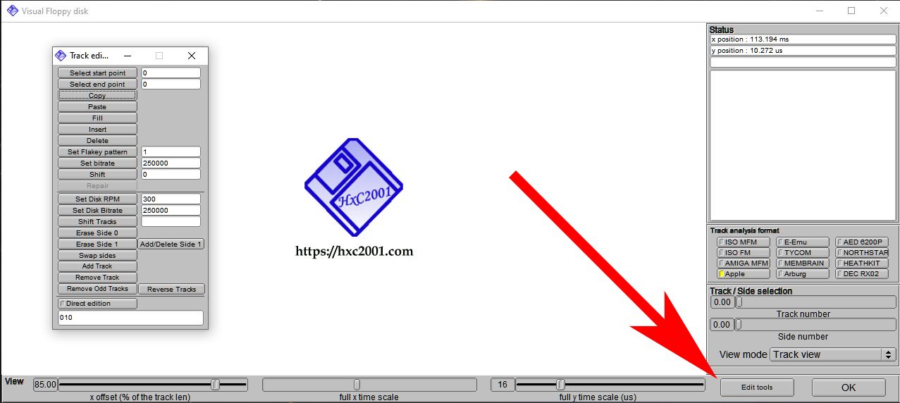

After browsing a good part of the forum, I did not find any documentation on how to use the "Edit tools" and "track editor" part of HxCFloppyEmulator software v2.4.1.5
I'm currently "dumping" 5.25" Apple IIe double-sided floppy disks with a kryflux card to make some videos on this subject.
I managed to get images of the 2nd side (.DSK) by cutting the floppy disk and physically and carefully flipping the floppy disk over ... a bit barbaric, but it works ... šŸ˜€
I manage to produce a .dsk file for each side by setting the Kryoflux DTC software in DSK mode, DOS 3.3 interleaves with this method.
I would like to try to create a .dsk or other files readable on an Apple II emulator with your software and test the reverse track function for this kind of double sided floppy disks.
With HxCFloppyEmulator software, I can import the .RAW file stream, using the reverse track function, there is Apple II 6A2 data on both sides.
With the documentation, I may be able to understand the different functions ...
I tried to export as a KF stream file (.RAW) to use these raw files in Kryoflux and produce a .dsk ... without success ....

But if you read my previous post, it concern how to use the "Edit tools" and "track editor" in HxCFloppyEmulator software ?
Edit tools.png (55.34 KiB) Viewed 3113 times
