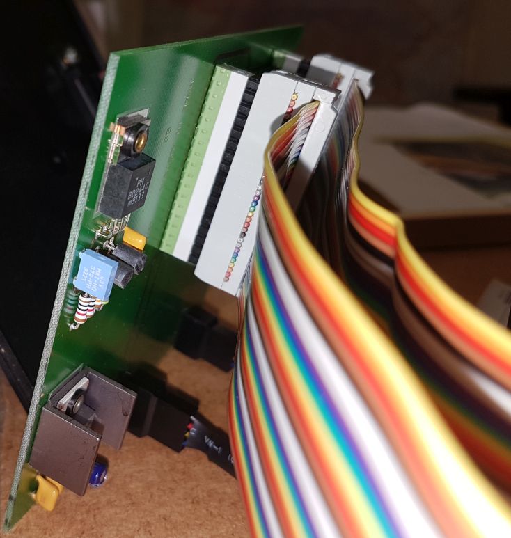

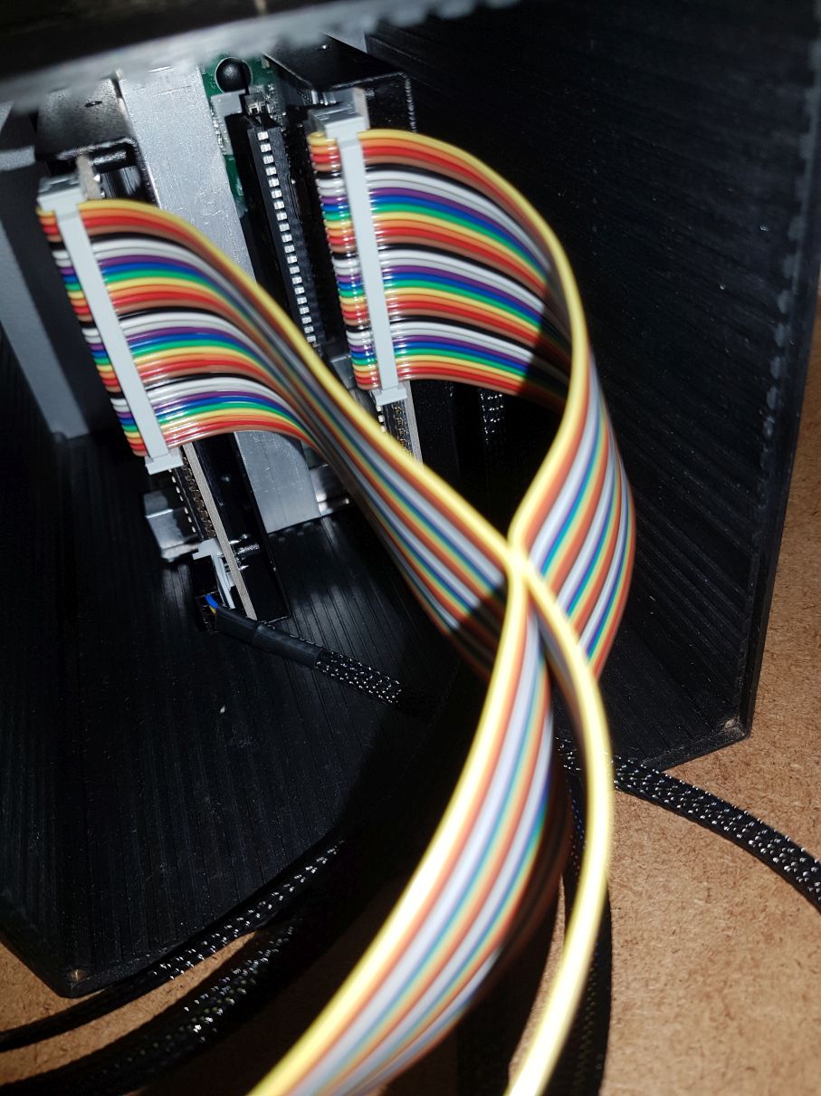

Here are the pictures of the ribbon cable(s).
Normally you put the drives directly to circuit board but the power and data connector differed a little from the emulator bit so I could not connect the drive directly but had to take cables.
A picture from the LCD follows today. The machine is running with real floppys today

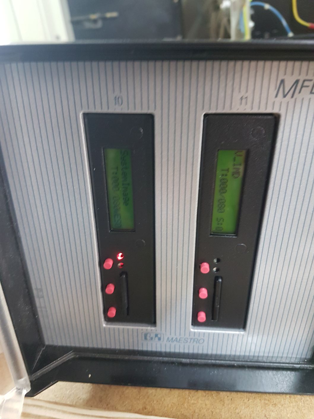

Here are the LCD pictures.
My Floppy Emulator settings
load last loaded floppy
2 Drives emulation
Interface setting Drive A and Drive B: IBM PC DD
Jumper setting: physical emulator 0: IDA0 on IDA2 on -> Motor enable a and DRIVE A: (Dip Switch Number 1 and 3)
Jumper setting: physical emulator 1: IDB1 on IDB3 on -> Motor enable b and DRIVE B: (Dip Switch Number 6 and 8)
If I reset the eeprom and use the cfg settings from the software then the left LED of both emulators lits permanently as you can see in my attached picture. (after a while standby...)
If I set the interface settings via menu on the emulator then the left LED of emulator 0 flashes fast and after a while standby flashes not so fast. But left LED of emulator 1 still permanently.
I tried IDA0 and IDB3 both set to off with same results.
Please can you help?

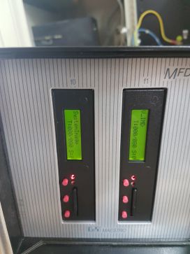

OK, I tried settings for twisted ribbon cable:
IDA1 on (DRIVE A) IDA3 on (Motor enable a) (DIP Switches number 2 and 4) emu 0
IDB0 on (Motor enable b) IDB2 (DRIVE B) (Dip Switches number 5 and 7) emu 1
What happens: The mysterious WE occurs in the LCD ;-) ->>> What does this mean???
Please see the attached picture.
Please can you help?!?!
- 20200402_154613_WE.jpg (165.71 KiB) Viewed 45057 times
Re: floppy access LED is permanently lit
First error was IBM PC DD Interface config -> it was a shugart one which was detected by the missing PIN 3.
Second error was the flipped ribbon cable.
Now it works! I have only tested drive 0 but I think second drive will work too. I have only 1 cable at the moment.
Thank you for developing this emulator.
Stay healthy. I wish you all the best.
