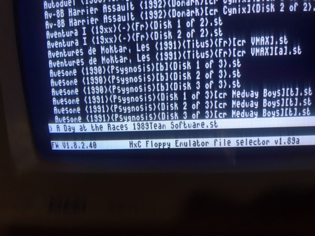

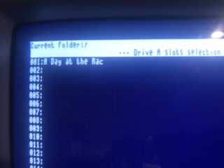

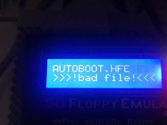

I am using the latest firmware that is on the site along with the latest Atari st loader. Firmware: 1.8.2.40 Loader: 1.89a
I included a few pics of the files I am trying to load. It always comes up as a bad file and when looking at the drive 1 slot it doesn’t show the entire filename.
Re: HXC2001 and long filenames
You are trying to load ST files. This emulator support only HFE files.
