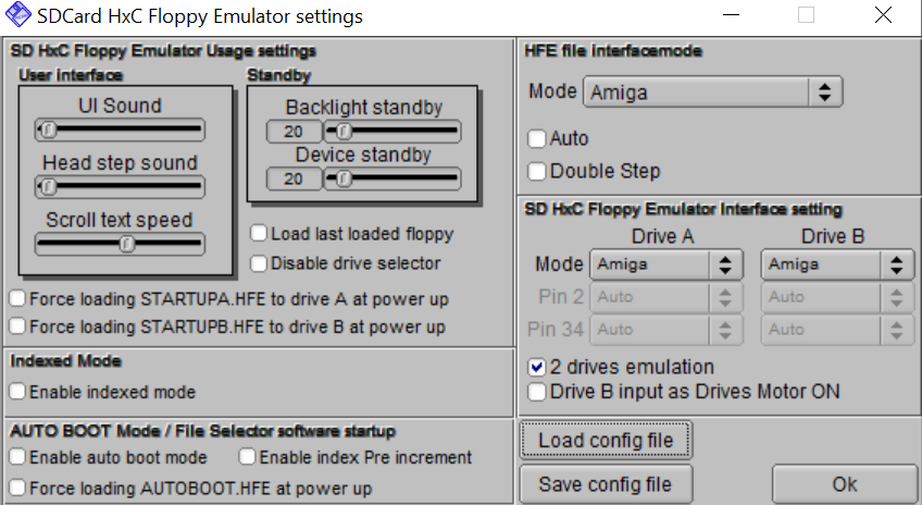

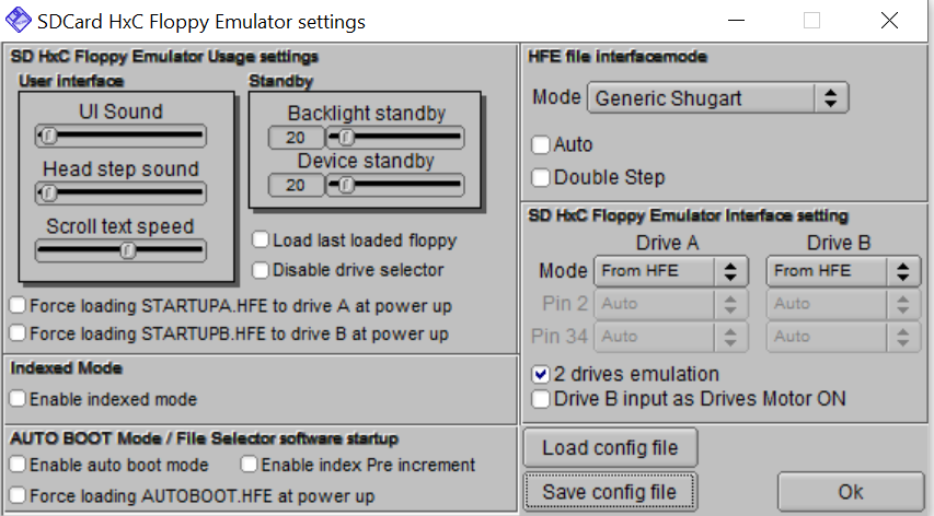

These are the two configs I have tried.

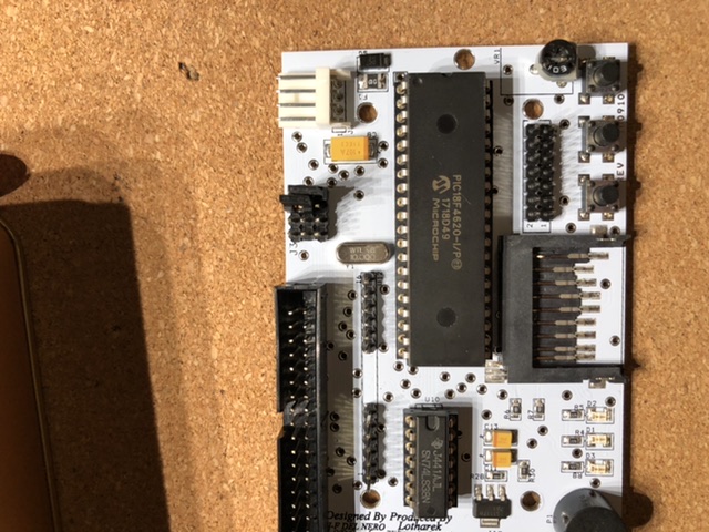

The HxC is connected as the internal floppy.
Here is a picture of my jumper settings. Anything obvious wrong?
