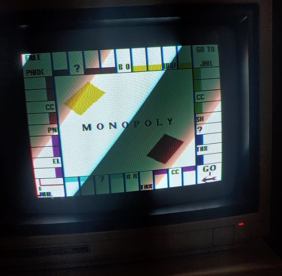

For reference, this is working very well.
Jeff provided a converted HFE Trackstar boot disk that works perfectly (so far), and I've been able to load a converted Apple II Monopoly disk from Gotek with no issues!
Apple compatibility with Gotek on my Tandy 1000 achieved! Hopefully disk writes work, we'll soon see.
- monopoly.JPG (43.9 KiB) Viewed 14330 times
