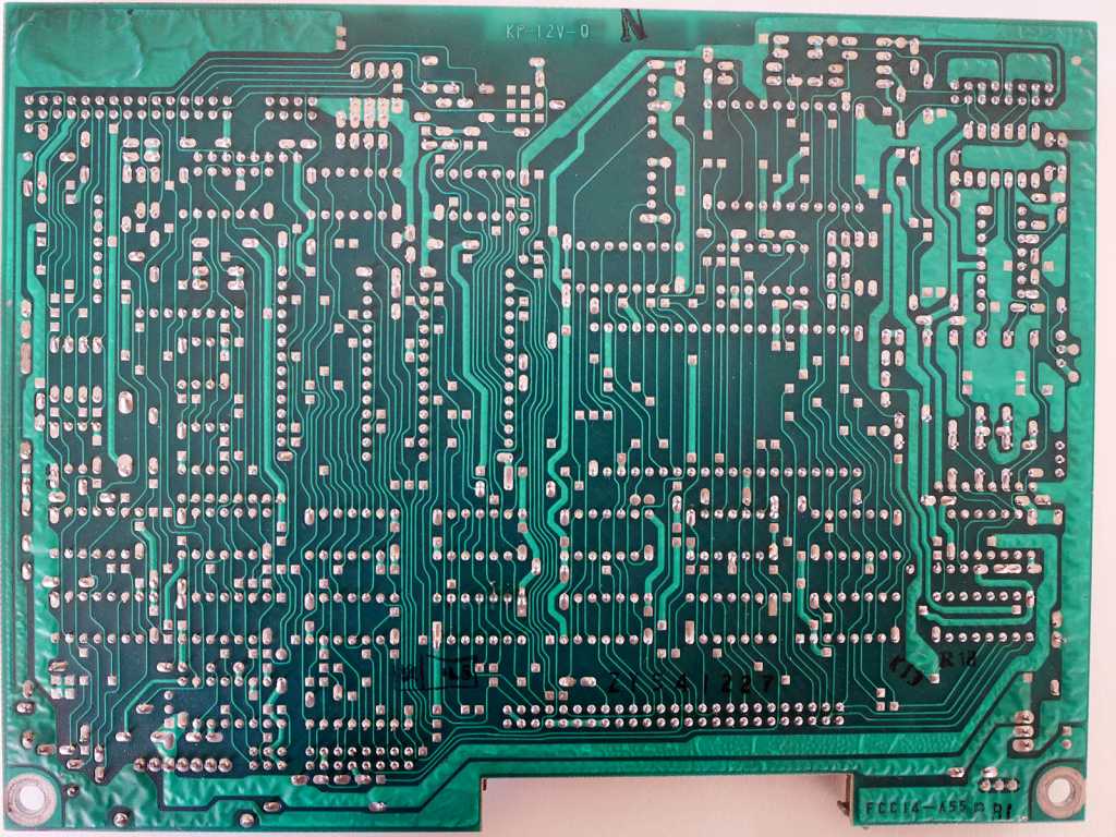

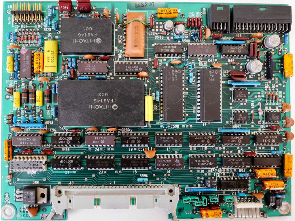

Lot's of IC on this drive... Can you make a better picture of the PCB ?

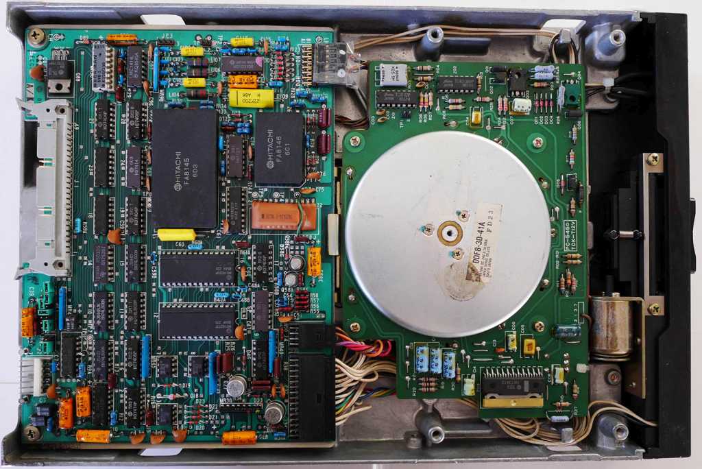

Hi Jeff
Here are some images of the Drive and the PCBs.
Thanks for your help!

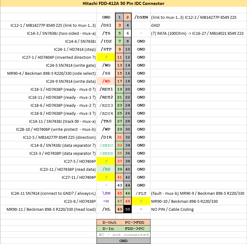

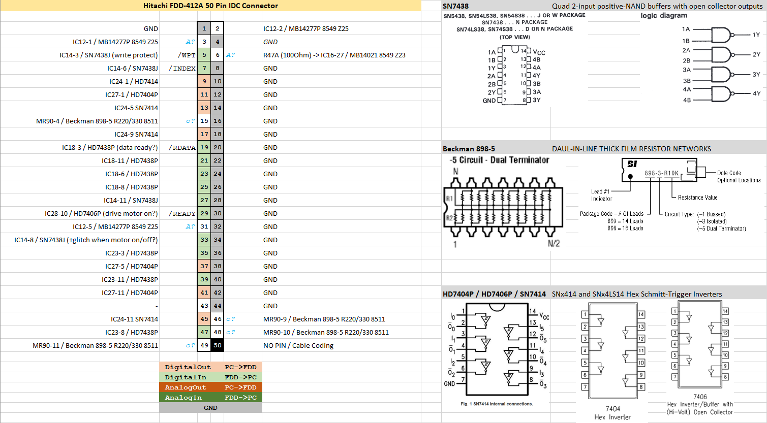

Trying to understand the pin assignments on the 50-pin IDC connector I followed the PCB traces ... still a work in progress.

Unfortunately it is not looking like a YD-180 pinout. I have most of the signals on odd pin numbers and measured the /INDEX pulse on pin 7. Just updated the table above ...
Thank you anyway!

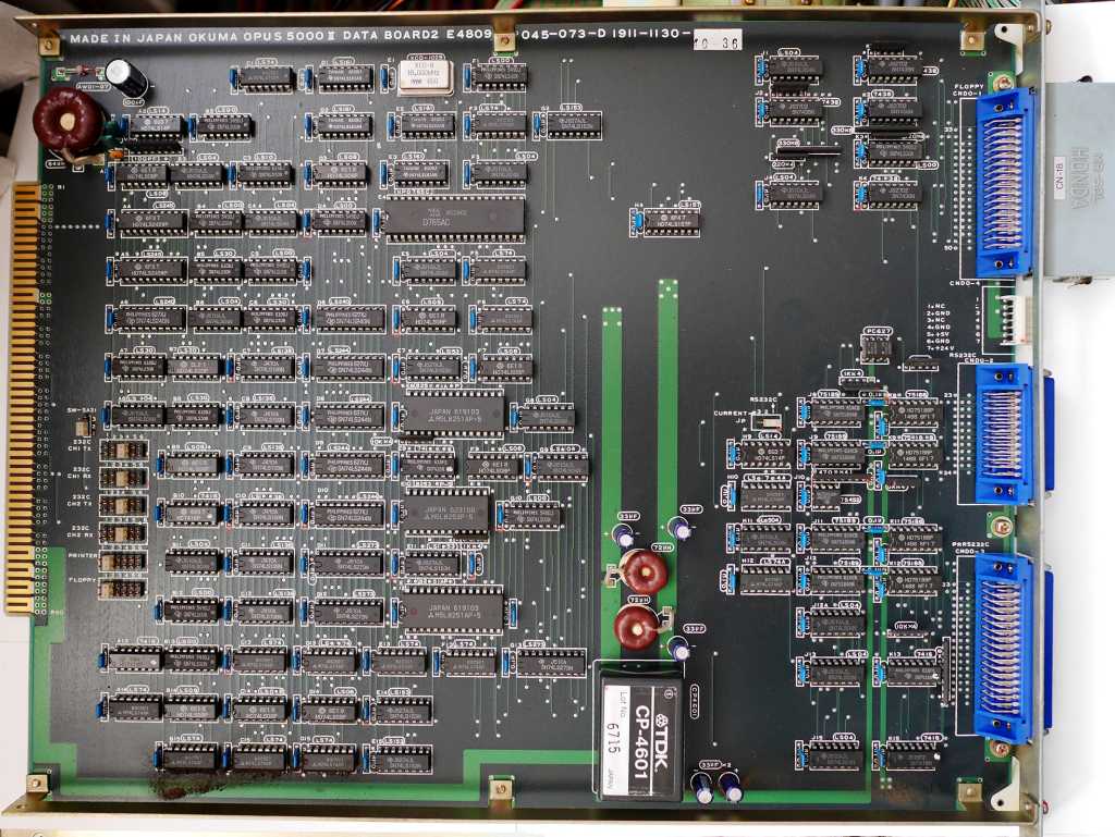

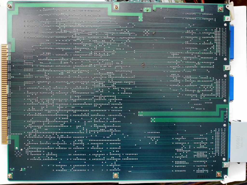

Here some additional images of the Floppy Controller PCB.

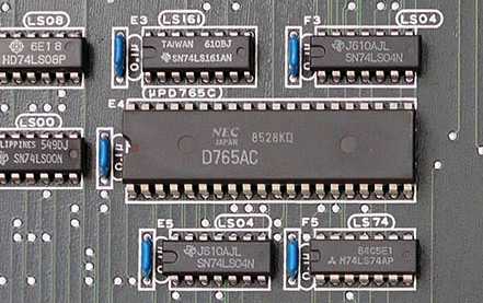

Re: Hitachi FDD-412A 8 inch floppy drive
Is there a NEC 765 floppy controller ?
Post by m.vgunten »
Bingo! :D
Thanks a lot your hint will help finding the signals on the floppy connector!
http://www.cpcwiki.eu/imgs/f/f3/UPD765_ ... _OCRed.pdf

Updated pin assignments on the 50-pin IDC connector after having a closer look to the floppy controller PCB ... still a work in progress.

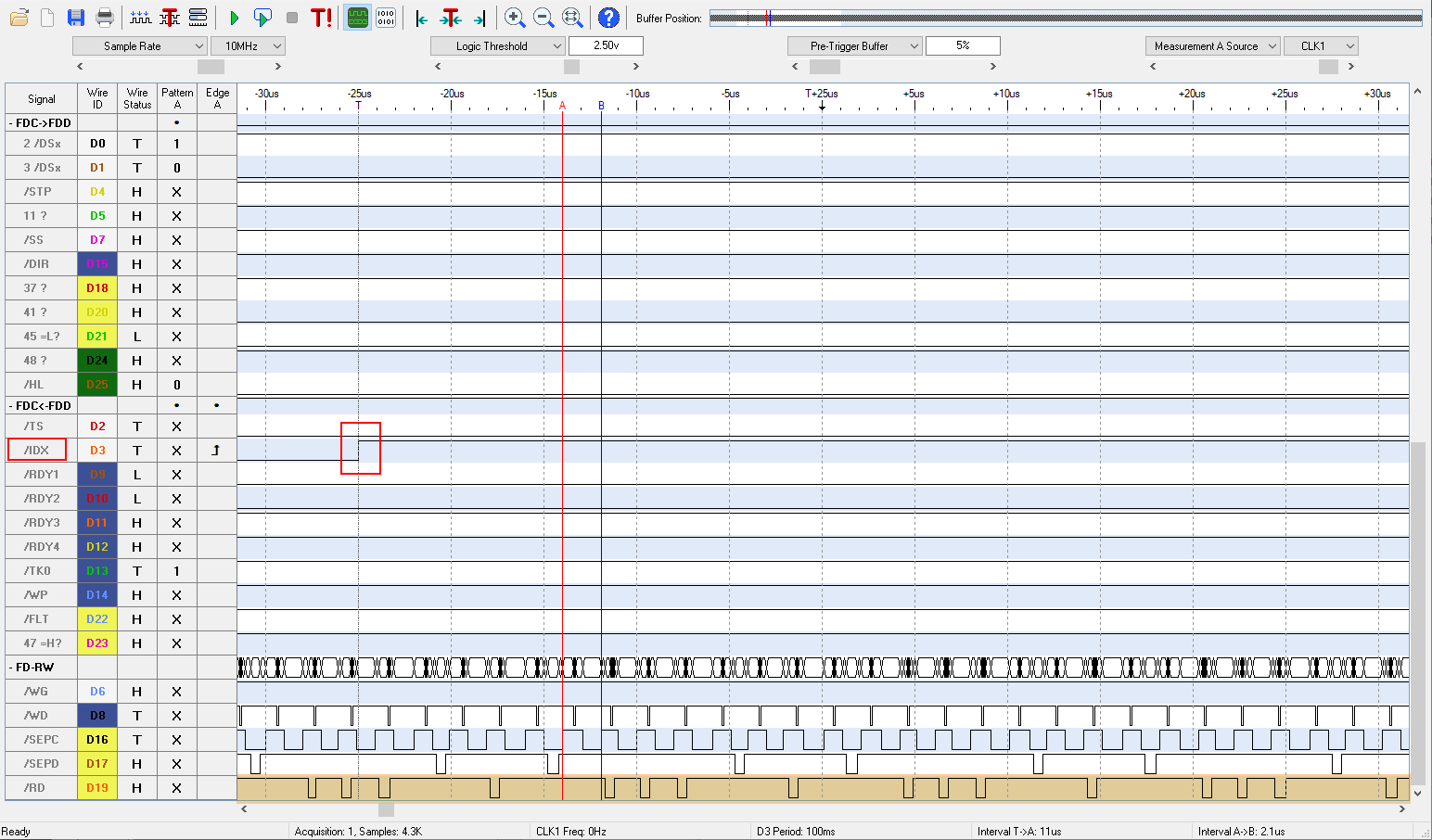

I can now control the floppy drive and read some date on the /RD pin - see bottom line in diagram below.
I further assume data separator clock /SEPC and data /SEPD on the two lines above (D16&D17) ... but I'm not sure at all!
m.vgunten wrote: Sun Jan 26, 2020 6:30 pm I further assume data separator clock /SEPC and data /SEPD on the two lines above (D16&D17) ... but I'm not sure at all!
Yes for sure this is data separator outputs !
