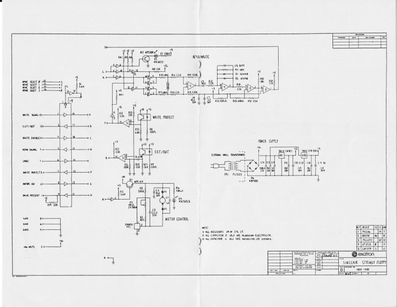

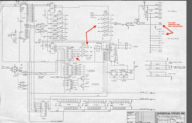

I've attached a schematic I found... I wonder if this would be as easy as the quick disk emulation? I would be willing to test the hardware side of things :)
Re: Emulating an Exatron stringy floppy with a gotek?
z23 wrote: Thu Sep 19, 2019 7:04 pm I've attached a schematic I found... I wonder if this would be as easy as the quick disk emulation? I would be willing to test the hardware side of things :)
Have you a schematic with a better resolution ?

Well, here is the source file I found, it was much larger file that I could upload here. It is a little difficult to read, but I think the pinout is the most important, correct? Also, ignore the power supply since this schematic is for a different device all together. The prophet 10 will have a 5v tap for sure to pull from somewhere.

The Prophet 10 service manual is a little convoluted... the only page I could find skimming through dealing with the tape drive can be seen in the below link. It is attached to the sequencer board.
Prophet 10 Schematic Sequencer board (to tape output)
https://www.dropbox.com/s/gai0mrtd5sef8 ... e.jpg?dl=0
This seems quite simple. Have you the hardware and the necessary stuff to take some signal captures ?

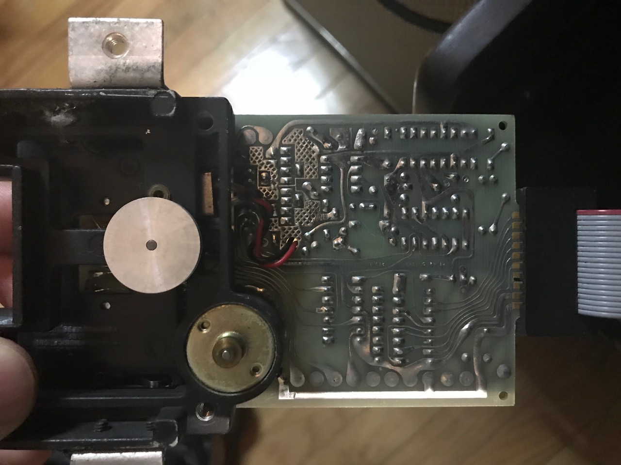

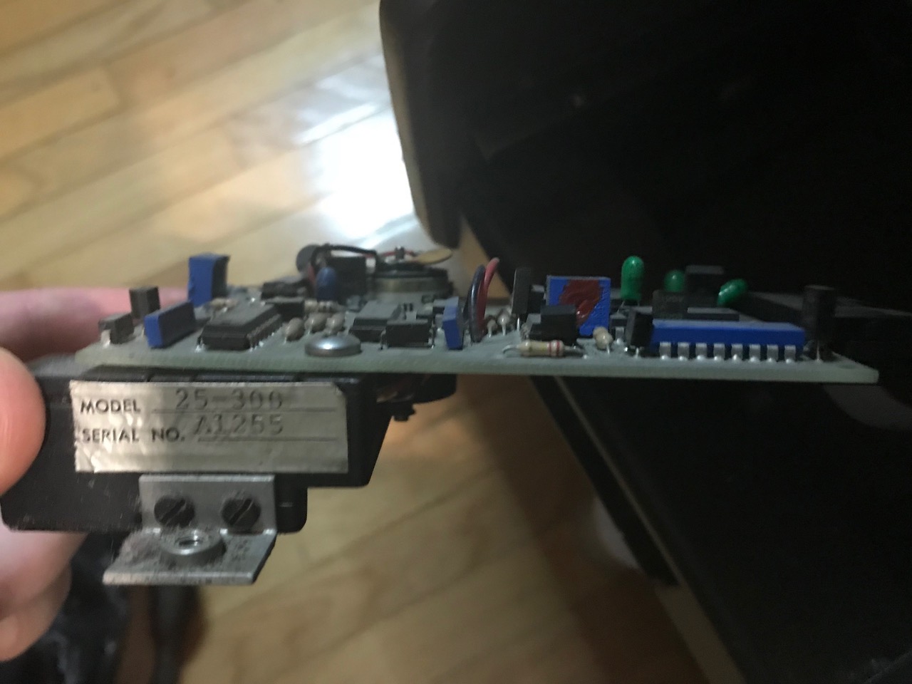

Here are some pictures of the actual drive:

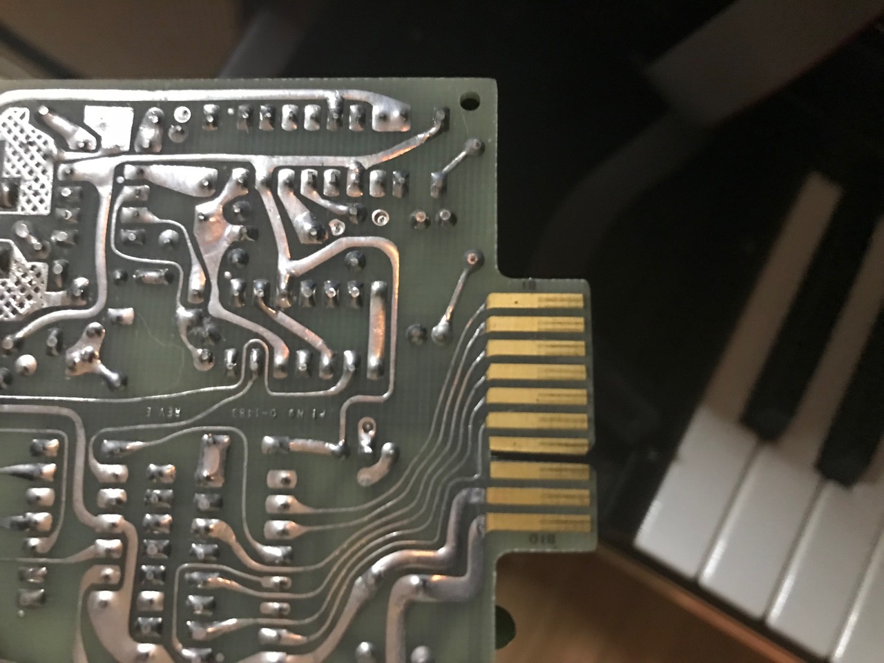

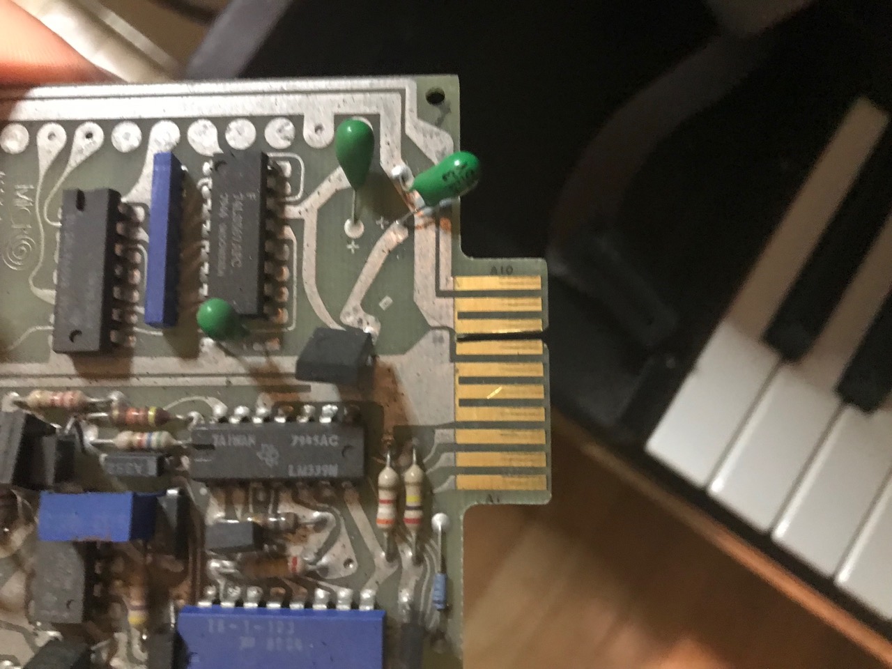

more pics:

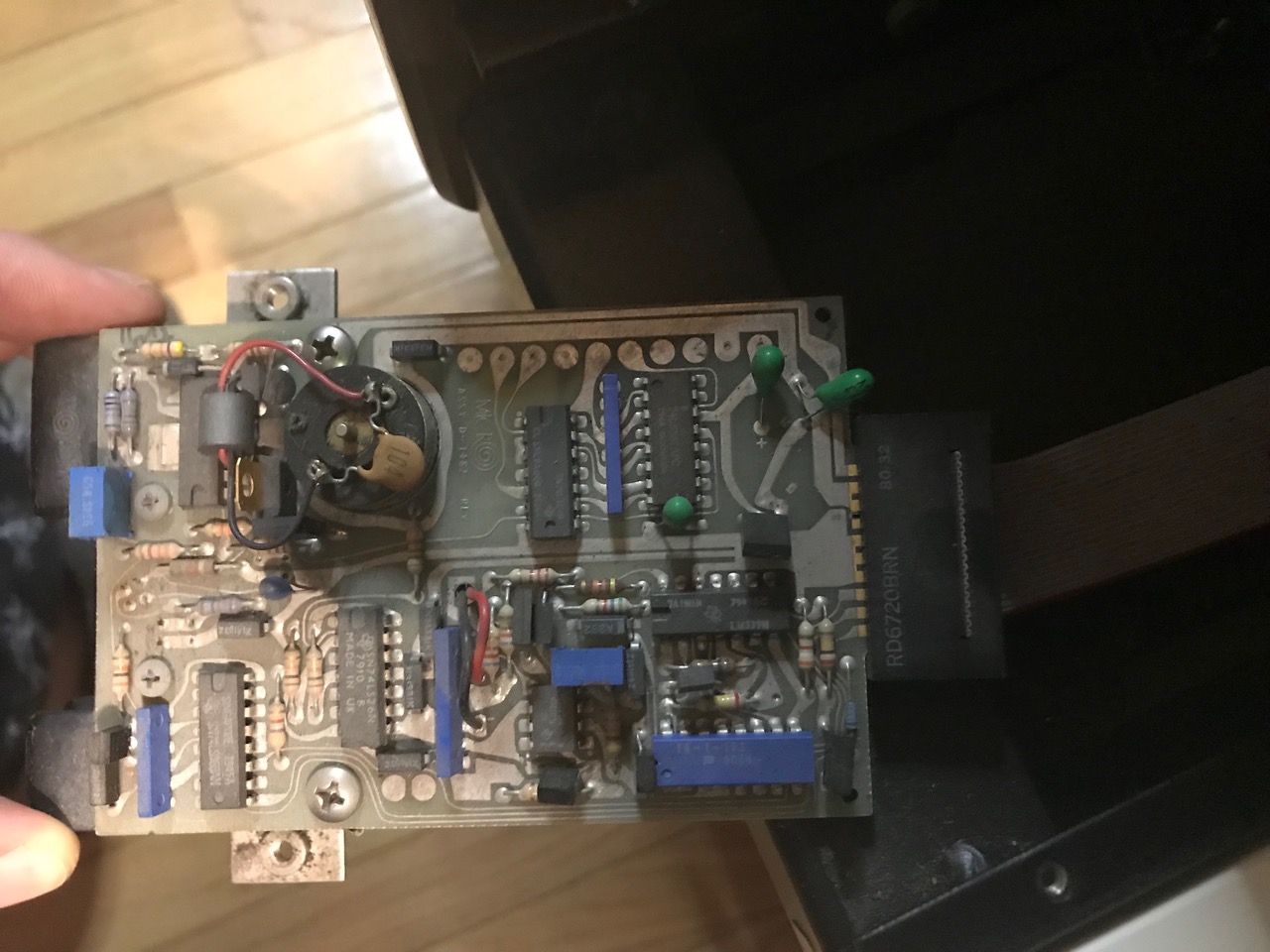

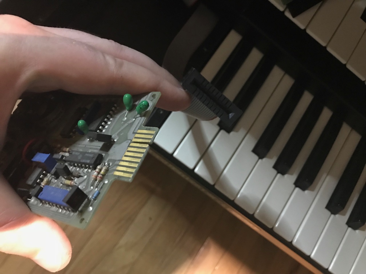

last one:

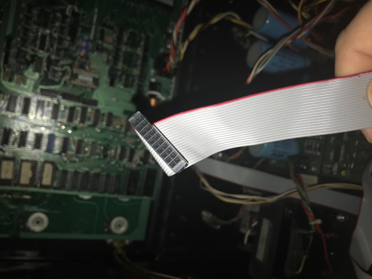

Last thing, I've found and marked all 20 pinouts from this sequencer board to the Exatron drive in red for easy reference. A new high quality file can be downloaded here: https://www.dropbox.com/s/062jg5g1o9bug ... 9.jpg?dl=0
Otherwise a low res is below:

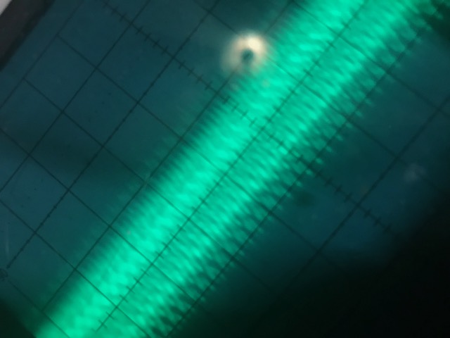

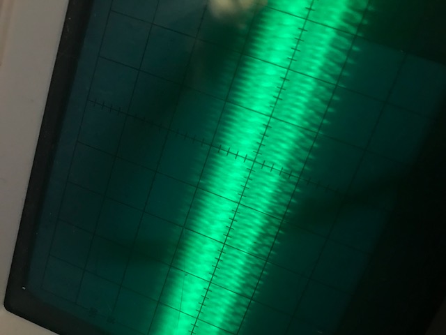

Well.. I just fixed my prophet 10 power supply and the Exatron drive... received the new tape, went to see what was happening on the oscilloscope and then the tape got eaten. I saw what looked like square waves while it was saving, and without a tape I get some weird shape while reading. I honestly don’t know what I’m looking for, what settings on the scope I should be set to ( had it at 20mv/div and h was set to .1ms). Does this waveform look like what we should see?
