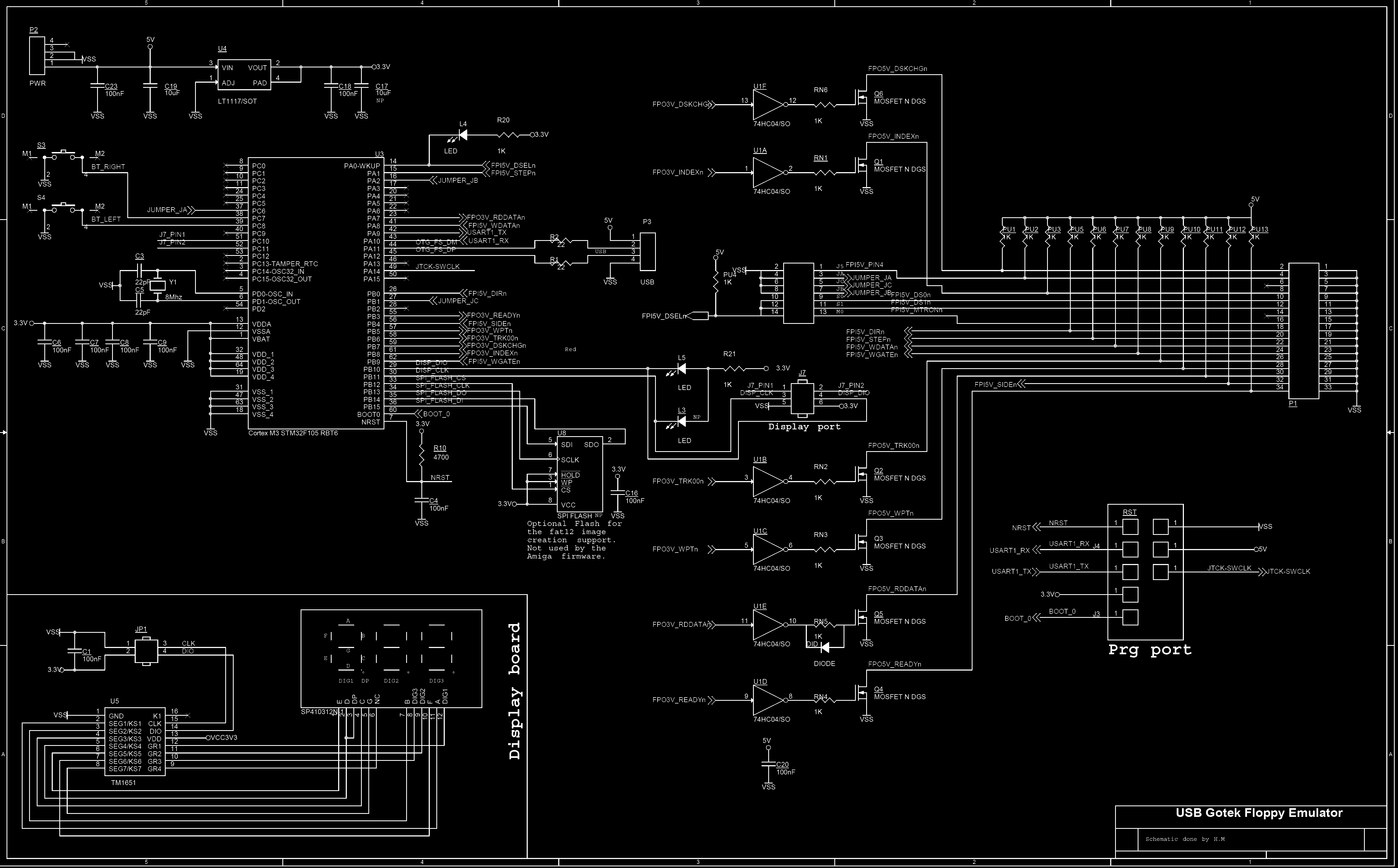

Sorry, excuse my ignorance - what do you mean by 'ADC input' and 'Port A'?
Which of the pins in the schematic below are you referring to?:
The GPIOs supporting analog mode are : PA0, PA1, PA2, PA3, PA4, PA5, PA6, PA7, PB0, PB1, PC0, PC1, PC2, PC3, PC4, PC5.

Looking at the available analogue pins on the Gotek STM32 chip, probably the easiest one to hook on to is PC1 (pin 9) or PC2 (pin 10).
