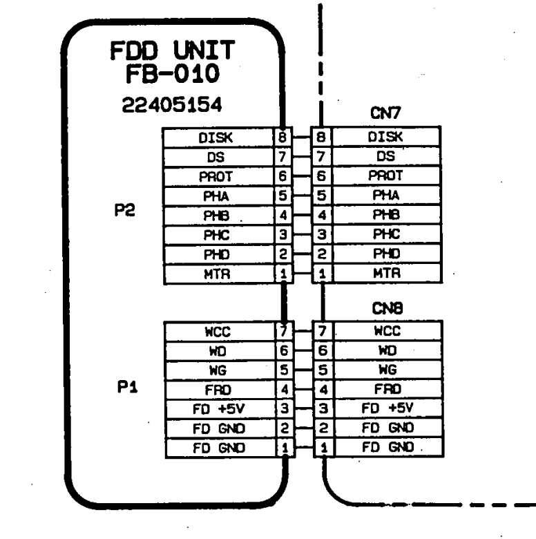

I found out the service manual (here) and here is the wiring of the floppy
Could it help to fit a standard floppy, and thus a HxC drive into the D20 ?

Would anyone mind doing a sanity check on my notes? I compared the image above from the roland D20 service manual, and the Apple drive notes, but the indicators aren't 1:1. I did some guesswork to try to determine the pins that didn't match.
Edit: I dug into this a bit more and made some changes. There's 1 pin I'm really uncertain about CN8 Pin 7 on the D20.
CN7 pin (8) [DISK] =====> [DS0] Gotek DB 19 pin (10)
CN7 pin (7) [DS] =====> [/SIDE1] Gotek DB 19 pin (32)
CN7 pin (6) [PROT] =====> [/WPT] Gotek DB 19 pin (28)
CN7 pin (5) [PHA] =====> Gotek UART J4
CN7 pin (4) [PHB] =====> Gotek UART J3
CN7 pin (3) [PHC] =====> [/DIR] Gotek DB 19 pin (18)
CN7 pin (2) [PHD] =====> [/STEP] Gotek DB 19 pin (20)
CN7 pin (1) [MTR] =====> [/MOTEB] Gotek DB 19 pin (16)
CN8 pin (7) [WCC] =====> Gotek DB 19 pin ()
CN8 pin (6) [WD] =====> [/WDATA] Gotek DB 19 pin (22)
CN8 pin (5) [WG] =====> [/WGATE] Gotek DB 19 pin (24)
CN8 pin (4) [FRD] =====> [/RDATA] Gotek DB 19 pin (30)
CN8 pin (3) [5v] =====> Gotek Power (1)
CN8 pin (2) [G] =====> Gotek Power (2)
CN8 pin (1) [G] =====> Gotek Power (3)
Thanks for any help you can provide.

Re: Roland D20 Non standard floppy drive
This seems to be a mix up between the apple ii and quickdisk interface. some firmware changes are needed. Can you check the WD,WG,FRD, MTR, PROT, DS signals polarity ?Jefro wrote: Tue Jan 16, 2024 1:07 am Would anyone mind doing a sanity check on my notes? I compared the image above from the roland D20 service manual, and the Apple drive notes, but the indicators aren't 1:1. I did some guesswork to try to determine the pins that didn't match.
Thanks for getting back to me. That actually seems to make a lot of sense, given Quickdisk drives were in a lot of word processors, and Brother, who made the drive in the D20 also made a ton of word processors.Jeff wrote: Wed Jan 17, 2024 11:44 am
..anyway, I'll get back to you this evening with those details.
