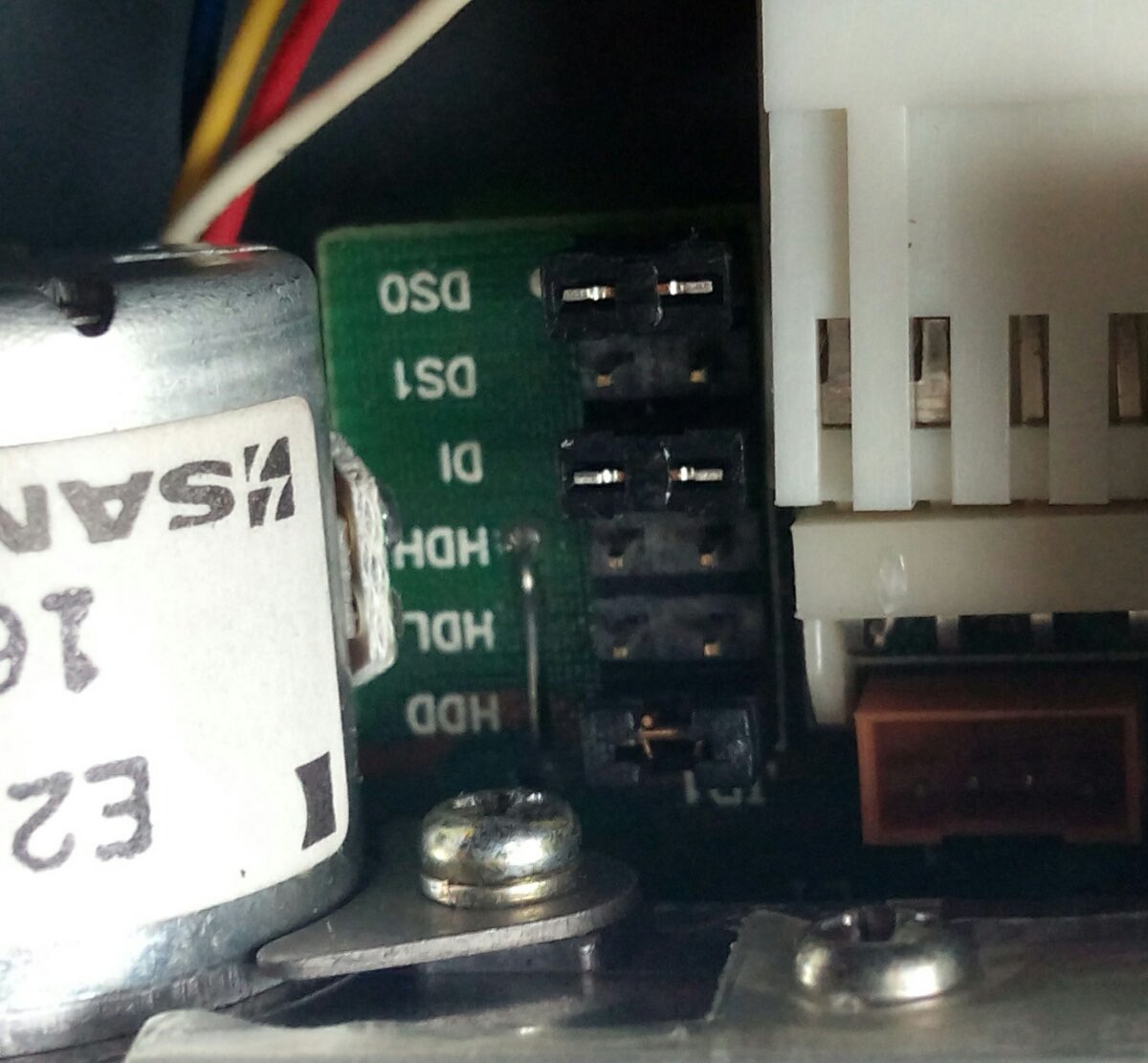

The disk drive is an ERGO MD-21-DS350-B1 with the jumpers set as in the picture. This disk drive does not work anymore, but it looks original.
I have another one of these SAM-1s which holds a TEAC FD-235HF which I have replaced many years ago.
Re: Double Dutch SAM-1 for Korg Synths
Ok then set the S0 jumper (remove all others if present) and try the IBM PC Interface mode. If still doesn't work set the S950 HD interface mode.
