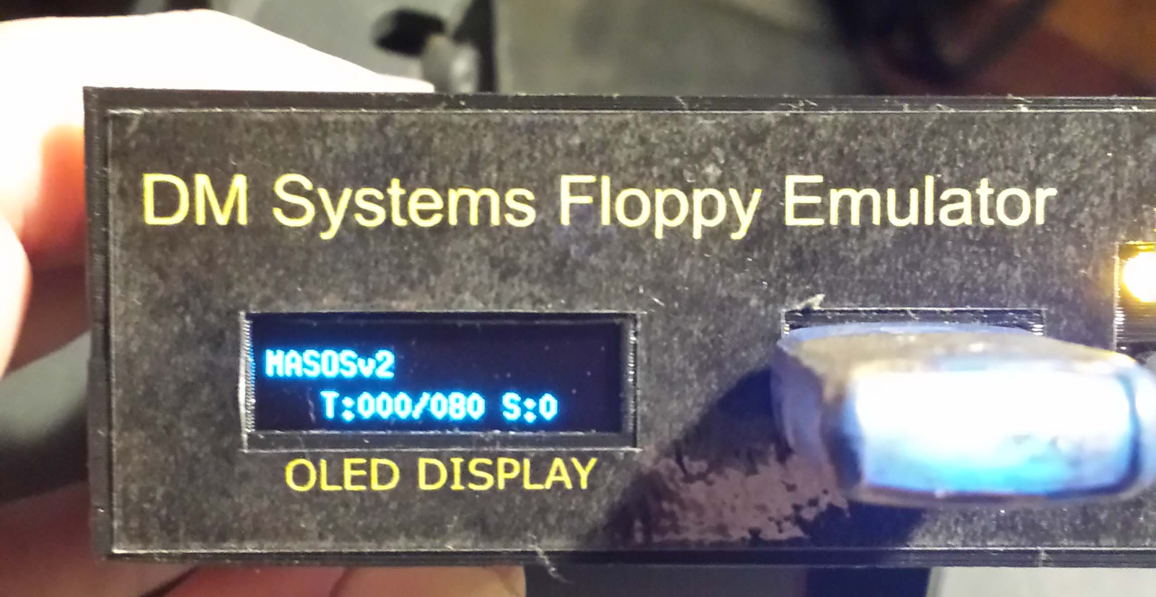

it says choose file i scroll to one of .hfe files - i have pic of MASOSv2 - under it is T:000/080 S:0
Re: Ensoniq Mirage HxC problem
sampledandconfused wrote: Tue Dec 04, 2018 6:36 am it says choose file i scroll to one of .hfe files - i have pic of MASOSv2 - under it is T:000/080 S:0
And nothing else ? No "RA" and/or the green led blinking when the sampler try to read the disk ?

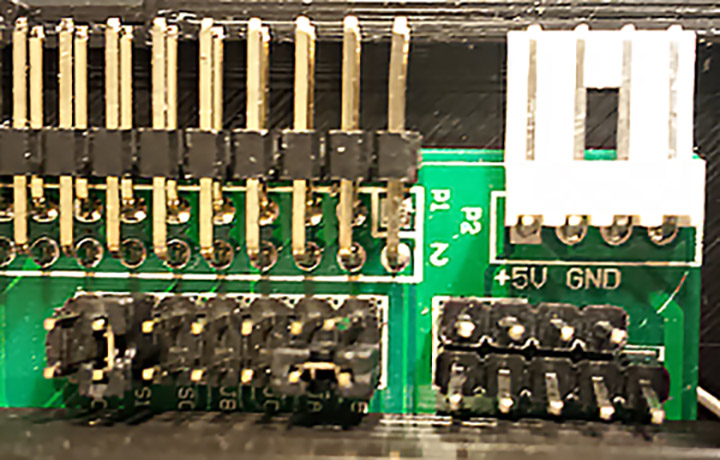

thank you - i will try tomorrow when I'm back in the studio - also here is a pic of the jumpers someone told me they might not be positioned right I tried looking at the schematic but was unable to figure it out - my mirage is the full keyboard with the red strip https://goughlui.com/wp-content/uploads ... 00K-UM.pdf

No that didn't work - I updated the firmware to the newest also -I'm not even sure of the procedure when it's workin right - should it just self load when I choose an OS or sound or do I use the load sample upper lower from the mirage which I've tried but didn't work bcuz no OS was loaded - thanks for your help so far I'm about ready to give up on it and get a sd one from lotherak
For the Mirage you only need the S0 jumper. Remove all the others.

It works! The jumper assignment was the problem - like you stated just the SO need to be jumped - now it loads when I turn it on - thank you
