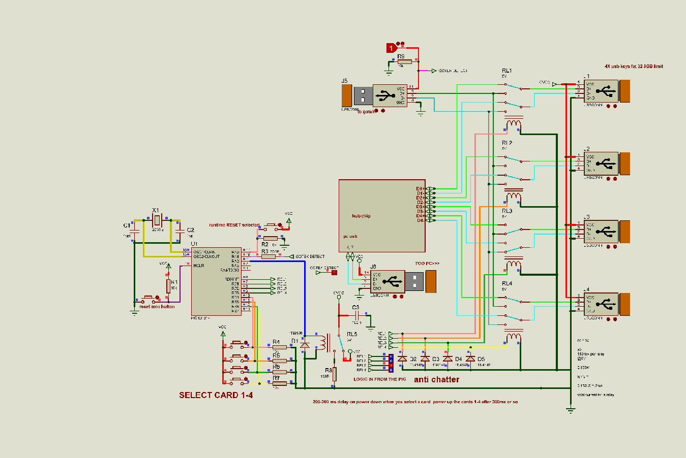

so with this design you can connect any usb device like a gotek or a laptop
to one of 4 cards memory etc
the cards can all mount too a pc via a hub
can be used to connect any two pcs etc pc mac shares 4 card etc etc
very flexible not just stuck too the gotek or even memory cards
but its what i had in mind when ive made it
some surgery and some parts about 20 euros to make one
some thin ribbon cable and a soic pic ive just got dil and it all open
soic recommended the single sided pcb type on the hub i got from ebay
i just drilled and placed vero pins in and cut the d- d+ track to form the switched pairs
dont laugh too much at the relays they solve many issues like a custom ic logic etc
not good
sometimes old tech meets new and marries
so some accepts on the schematics are for debug
take a look youll see whats done so far
the plan is not to ever power from the gotek etc
alone the gotek should have the choice of 4 cards no pc
or plug the hub in to external power as it has a small socket
and it can power vcc and also the cards not mounted too the gotek
and bound too the pc etc
so has a dual use as a 4 way bank select or interchange with the pc etc
very handy!!!!!

Schematics
Schematics
GOTEK 4 key switch automount pc main.jpg (135.35 KiB) Viewed 10267 times

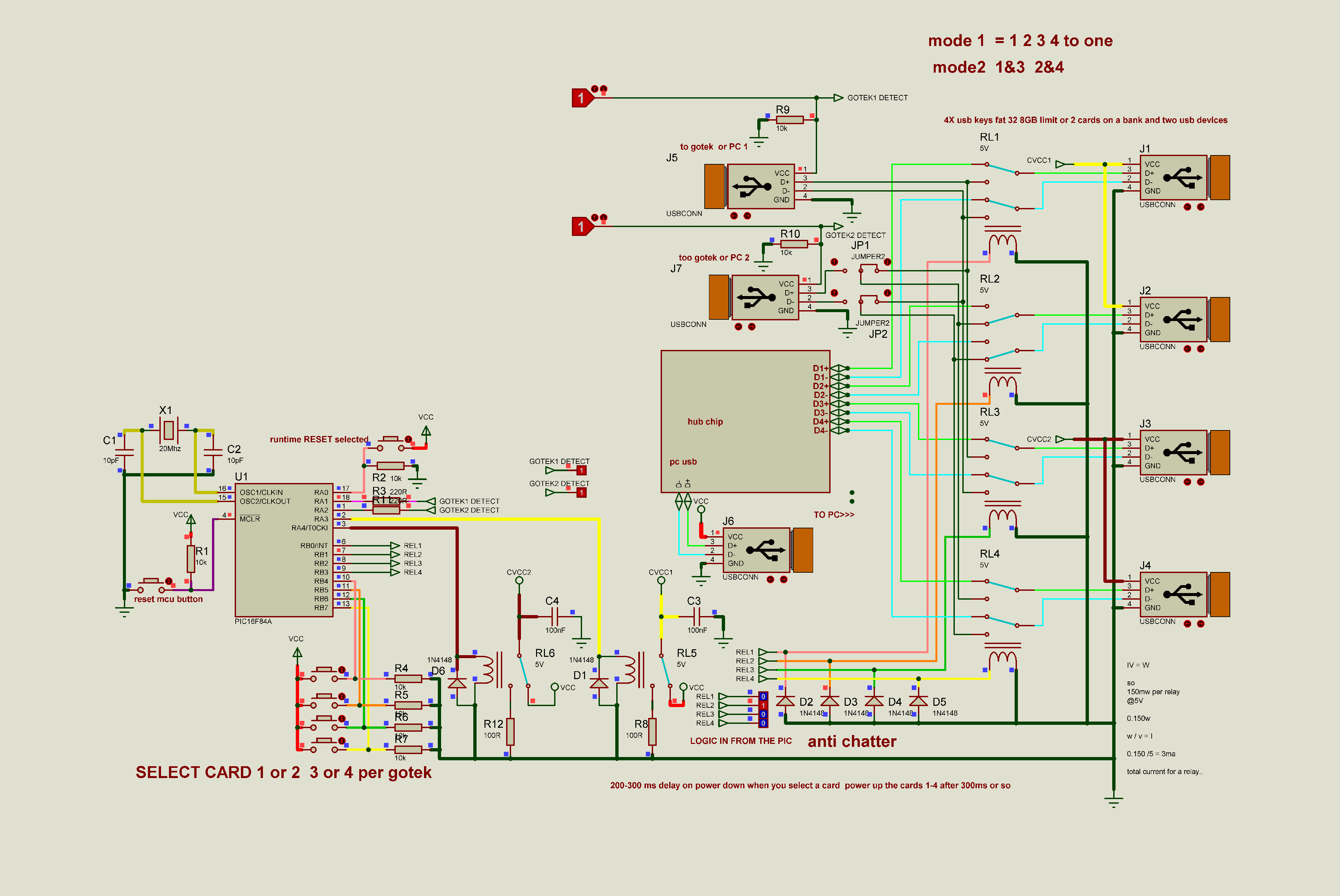

had a day off so got on with the designs
0.9 designs 0.1 revision
ive added two goteks share two cards each with the pc select deselect
ill fix another code block ill prob use another relay...{done!} for switching per bank
some keyboards{synths samplers} :D floppy ones setups will work with this nice...
with goteks i use a 6pin {and ground} svideo sockets and standard cables
does for rotary encoder and also the lcd etc and they are all now mega cheep :P
just enough connections 7
so this addition 0.9 allows two goteks to use up to 2 cards each and the pc can own one or two
or all etc select deselect
:roll: just stakein the claim on this accepts
.8 will always be 4 to one |& pc bin is 0000 0001 0010 0100 1000
.9 will always be 2 to two |& pc bin is 00 01 10 per bank 2 banks 00-01-10 00-01-10 no 11 on any bit group
:wink:
i think with some help we can move this easy code for this pic over to SDCC and codeblocks
and then its free i like picc but its easy bin select code and better off for us all within free tools
a? any helpers @? ps... its not something i want to gain from this project its for us all
and interlinking of cards within some sort of framework that can be used
i think its a good tool not just for goteks etc or memory but for any up to 128 or 256 devices and share
ive said ive seen 1 device shared with upto 4 pc
but never 2 usb shared with pairs ...
or even 1 with 1 of 4 gota love the relay a whole new usb respect too it
solves the issues flow.. sure... one thing missing in usb is device arbitration
would be handy...
2x GOTEK 4 key switch automount pc main.gif (224.65 KiB) Viewed 10123 times

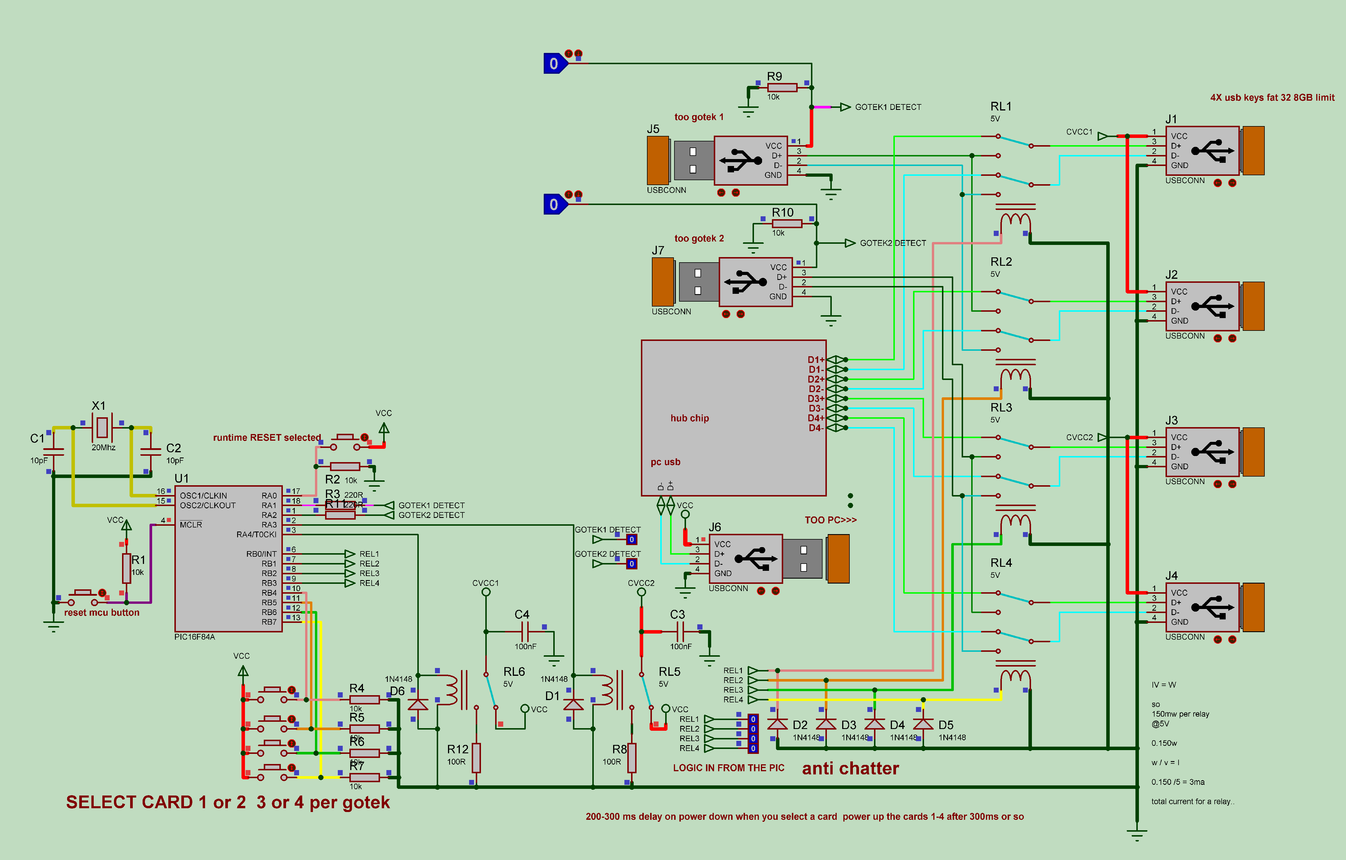

so v0.9.1 schematic
iron out the schematic first too the best fit
then the code flows better!! :?
yes i know it can be done in some custom vhdl etc easy
but pic is fun and cheep no special tools and a kit of bits can be used
with any cheep hub like the one i posted a link
ive reworked the ports and design to allow two modes
mode 1 is 1, 2, 3,4 slots on the hub can be available to the gotek or pc port 1
mode 2 is 1,3 2,4 slots on the hub can be available to the gotek or pc port 1 and 2
next ill make a small single sided pcb design board
that fits on top of the cheep hub!!
it will contain the soic pic 6 relays buttons and diodes, resistors all smd
so the code
ive started to rework it so you can choose mode
this is all done just the detect stuff to sort in the main routines
ill make a release soon
if anyone wants too build one
use the links at the top to get the bits
the pcb i am doing today
i expect a one of well debugged code
and as you need to use a soic ill arrange some sort of ebay for a chip etc programmed
as i say first power up you can choose mode
after this you can press all the buttons and power it
and it will reset mode... the unit defaults to mode 1 and can be set to mode 2
this is then stored till you again hold down all the buttons and power up
the jumpers allow to lock out port 2 for one port to 1 of 4 share
let me know any feedback :P | :cry:
views are very welcome :D
1 or 2 x GOTEK 4 key switch automount pc main 0.gif (173.57 KiB) Viewed 9968 times

The problem is that today very few people are willing to make the board themself... That's the issue with DIY projects.
About the relay : Are you using some specific model for usb differential pair ?
(i know that there is some usb multiplexer ic available.)

its better if some chinese company takes up the idea ??? 8)
and moves it too vhdl etc.. fpga small scale
as i said ive seen units too share one usb device with 4
but never a pc hub while connected share with 2 gotek up too 2 device each
or 1 gotek etc usb laptop etc share up to one of 4 devices with the pc hub
so this type is unique and i agree needs some custom thinking and a product
perhaps the producers in china will see a product in this
this the hierarchy of these devices is still being resolved
well mine works with 1 of 4 cards mounted too my laptop did have to use a 750ms delay
for 30 euros and a few bits of wire and program a pic...
im done with this ive no room in my life to give it space...
you affirm what i think its best left too a custom flash core stamp on a premade board
as it does confirm with usb switching :P
i do like relays as i say mine works so screw anyone else not willing to wire there own :lol:

relay switched has 0 zero latency
but a mux chip will always start to stack...
eek!!!
better too hard/soft switch usb plug in then power
as this devices tries too do
custom chips solve many problems and introduce others... :roll:
why introduce latency {ic's B to F } when you dont need it
just relays solves the usb issue's with multiple ics and many flashes and updates this and that
foe...
from now on ask jean
he owns the rights... :arrow: :D

looking more at this stuff
i see that a mux usb chip will need two support ics
1 micro and 1 16 way buffer ic all perhaps SMD
TOO COMPLEX 8)
when 6 relays and one easy program pic fits the bill
i built two for 30 euros still got most bits too make another 2
too build and rework will take a pcb
i dont use pcb just wire wrap :?
so you can make a pcb or buy one... if made
or wire wrap 6 relays and one soic pic 16F84 20mhz 1us PI
its a no brainer
perhaps it will be produced as a made up idea
i dont care i build another 3 no issues with relays
works with any usb 2 device
pc's seem to release it very easy esp memory cards
fixed devices are harder too shift
this design is as is
its been made too connect memory cards too both gotek
other usb units and two pc's share and mount :roll:
its not for any profit
if you dont like something
then post something better or say nothing :(
