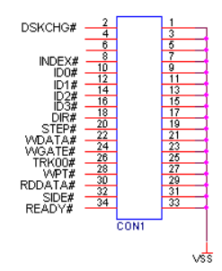

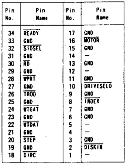

First I have a Yamaha Disklavier MX-100A. In the original post the author talks about having to have the schematics in order to cross reference the pinouts, this is red herring in my case. All I needed was 34 pin ribbon cable. The original one was too short as the HxC2001 Rev F has the 34 pin connector on the rear left side, so I scavenged one from an old PC. The original cable is a straight through, I also used a straight through cable. The only other hardware setting is making sure "ID0" is "on", all others should be "off". Attached is the schematic pinouts from the MX100a control board and the HxC2001, everything lines up.
MX100 CPU Floppy pinout.PNG (23.12 KiB) Viewed 46304 times
HxC2001 pinout.PNG (17.5 KiB) Viewed 46304 times
