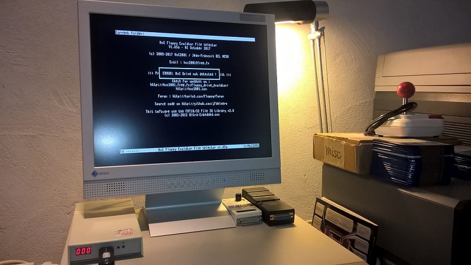

However when I run HXCFEMNG (V1.64a) first DF0: and DF1: blink (checking ?) and then the program gives me "ERROR: HxC Drive not detected !".
I get the same error if I run HXCFEMNG from the HD or from a floppy (tested from DF0: and DF2:).

- HXCFEMNG can't find DF2:
- WP_20180504_10_27_32_Pro.jpg (218.88 KiB) Viewed 11857 times

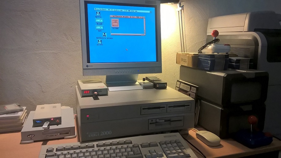

- Drive correctly detected as DF2:
- WP_20180504_10_26_28_Pro.jpg (206.89 KiB) Viewed 11857 times

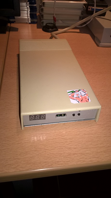

- Power Computing enclosure
- WP_20180510_10_53_41_Pro.jpg (148.37 KiB) Viewed 11731 times

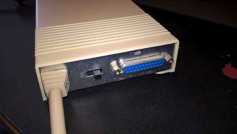

- Rear
- WP_20180510_10_53_01_Pro.jpg (176.64 KiB) Viewed 11731 times

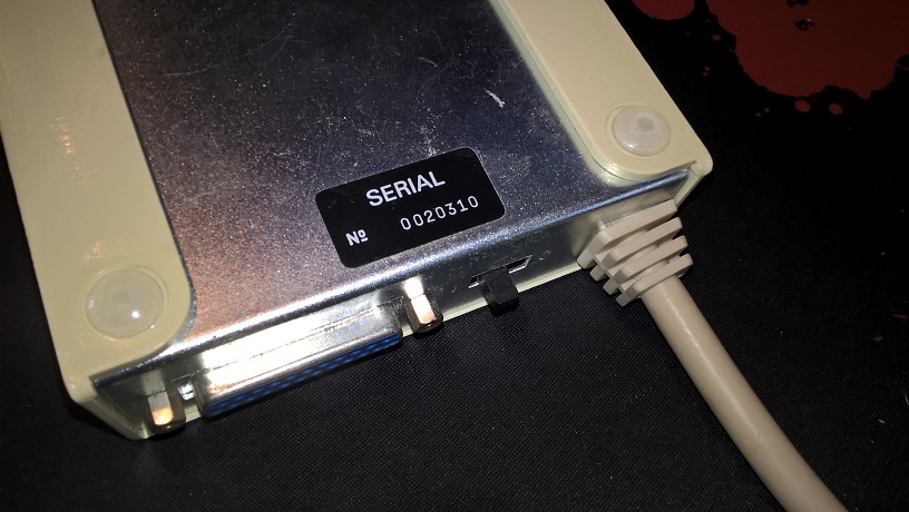

- Serial number
- WP_20180510_10_52_41_Pro.jpg (186.61 KiB) Viewed 11731 times
