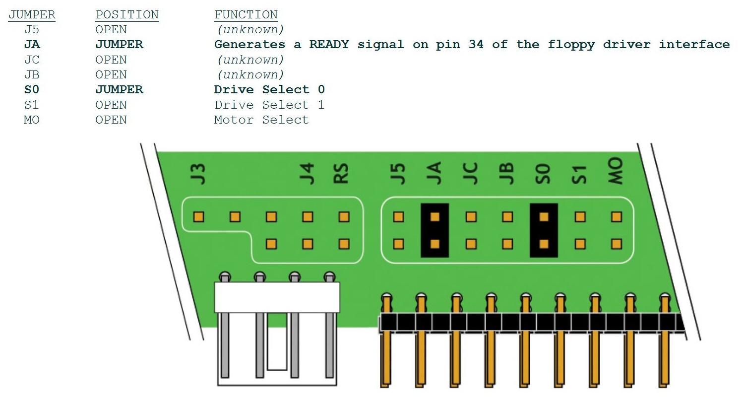

s330guy wrote: Sun Aug 06, 2017 11:19 pm hey all, thanks to jeff and everyone who support this project. i'm trying to flash my gotek for use in a roland s330 sampler and cannot get the device to be recognized, niether on a windows 7 or a windows xp computer
i soldered the connections exactly as it is done in this tutorial: https://www.vogons.org/viewtopic.php?f=46&t=43416
i installed the proper drivers for my usb adapter, i am using the same one as in this tutorial. device is not detected
i tried to attach some pictures but it says file too large? it is a 300kb picture(?)
s330guy wrote: Mon Aug 07, 2017 1:25 am i should add that i am using the same gotek drive as instructed here for the roland s330: http://llamamusic.com/s50s550/DIY_page.html#usbfloppy
this is supposedly a version that will work with 720k disks. i notice the jumpers on it are different than the jumpers on the gotek in the hxc flash tutorial in the first post. maybe someone can clarify how to set the jumpers on the gotek before performing the flash?
also i am not clear on 'if it is not detected then short these two locations to reset'. can someone explain exactly what i am connecting to reset it (ie on the usb adapter or on the gotek)
:D i set the gotek jumpers like in the tutorial and everything is fine. mine had jumpers on JA and S0 and in the tutorial there was only one on S1
will report back on how it goes with the sampler(s)

Remove the JA jumper, this is a button function with the hxc firmware.
