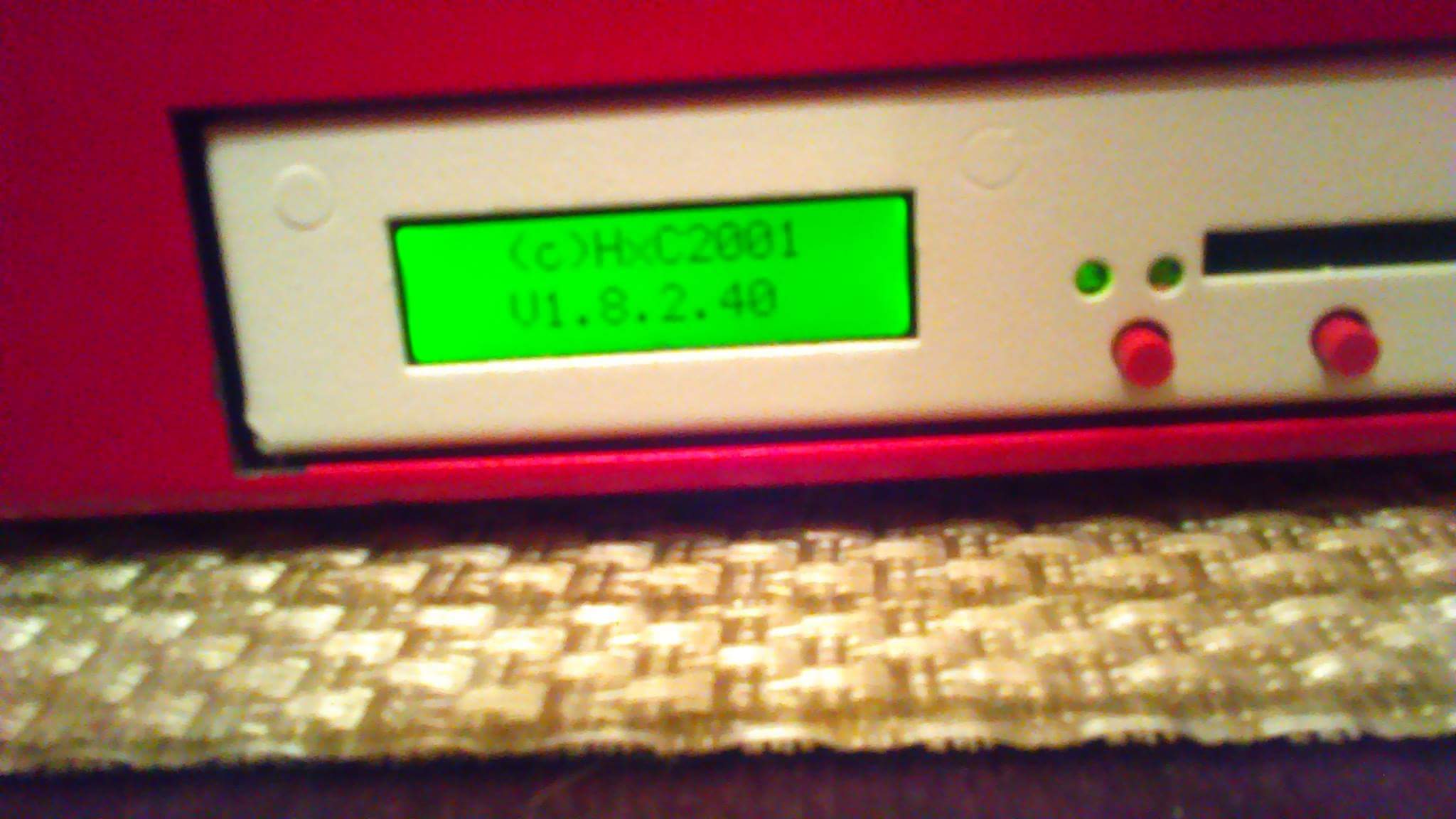

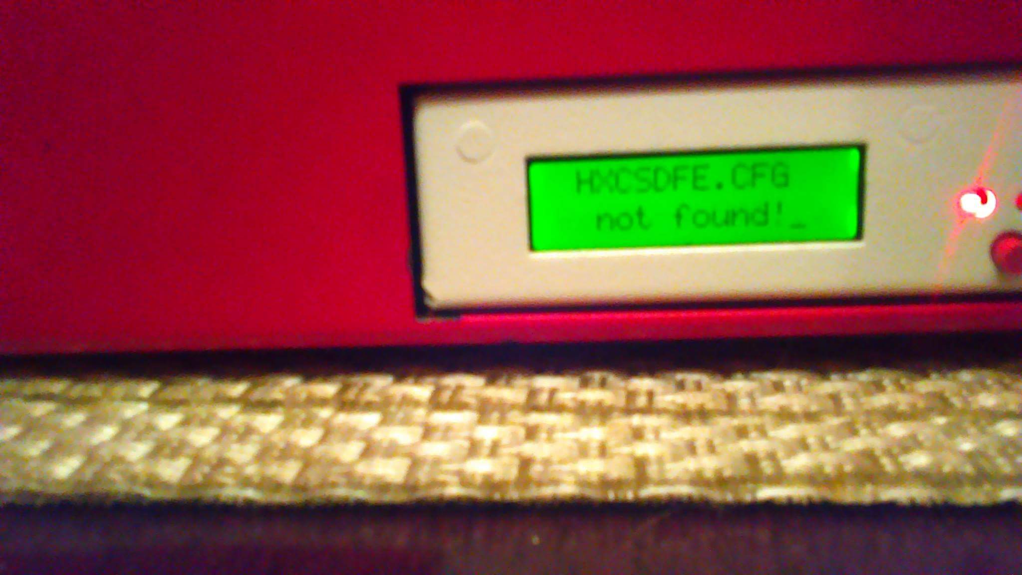

please post some pictures of your connections and hxc lcd screen.techthai wrote:I recently purchased and installed white rev F into my asrx, Now im lost! I tried using the asr10 cfg. file .. a few tips would be much appreciated..need a little direction .. thanks in advance Thai
Re: ensoniq asrx cfg. etc. HELP
Everything seems to work except I can't load files even with the ASR 10 configuration file on my SD card
- received_10154254921877414.jpeg (122.28 KiB) Viewed 16187 times
- received_10154254921962414.jpeg (136.86 KiB) Viewed 16187 times

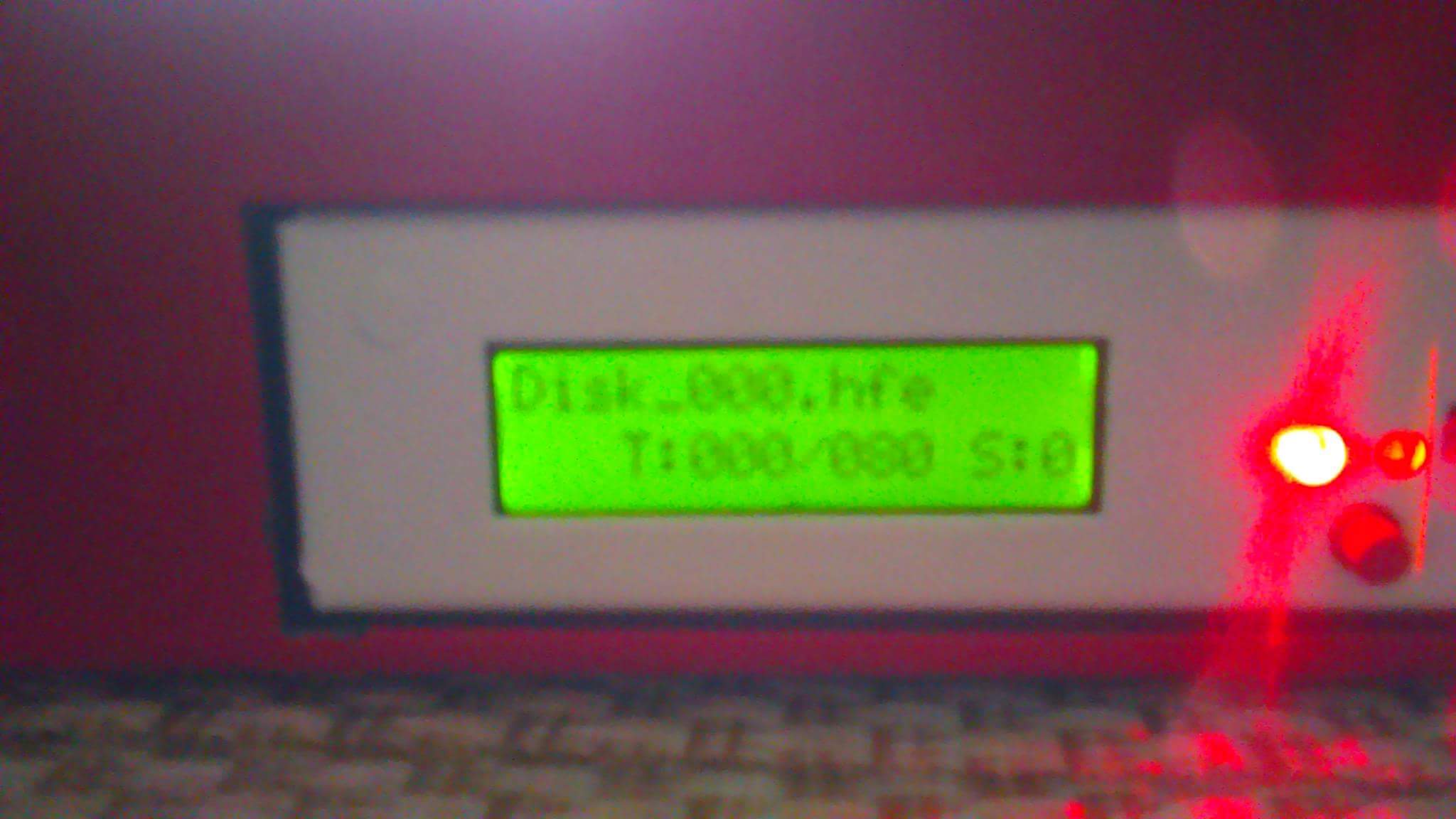

I also added a wav.file to the SD card , asrx will not read .. maybe I don't have proper files , I'm having trouble finding the information I need.

What is the old drive brand/model and jumper setting ?
the old drive is a sony mpf920-1 , I don't see any area for jumpers on old drive. I read on a list its EDA. ( https://hxc2001.com/floppy_drive_emulat ... SSUPPORTED ) from this page under ASR10 (which i believe has the same drive), also on the hxc gallery there is an asrx pro with the drive installed.. I think i need a disk image CFG. file? but I tried asr10 quick cfg. (no luck) and I just have no idea how i must load and save files. I really hope to get it going .. I'm am an electronic tech thats what i do for a career i didnt expect it to be this difficult.
