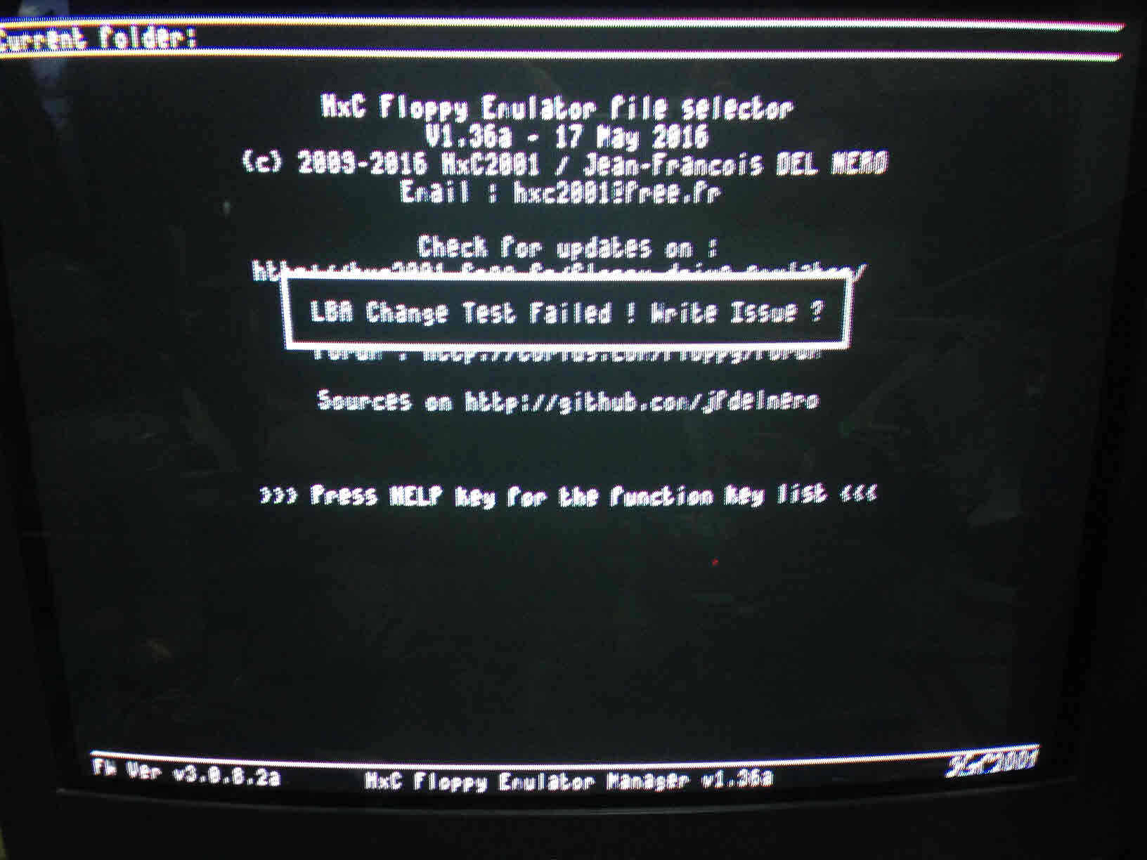

I own a gotek flashed with Hxc and I'm experiencing this kind of problems now (see picture) !
Could someone give me a solution for this issue ?
It also make this with my atari 1040 stfm ....

ref to this topic, it's the same here : https://hxc2001.com/floppy/forum/viewtopi ... &hilit=lba
"I did discover this: If I boot it in Autoboot mode it will error out from a cold start. If I Ctrl+A+A it works every time."
Cold start loading manager bug, the Ctrl + A + A and restart and work !! It's not the best solution, before it was working at the first attempt, but it's better then nothing ;).

it's the same on the Atari st side CTRL + ALT + DEL
Re: lba change test failed ! write issue ?
Zxquad wrote:it's the same on the Atari st side CTRL + ALT + DEL
So this sound to be an hardware problem.
Jumper setting ?
