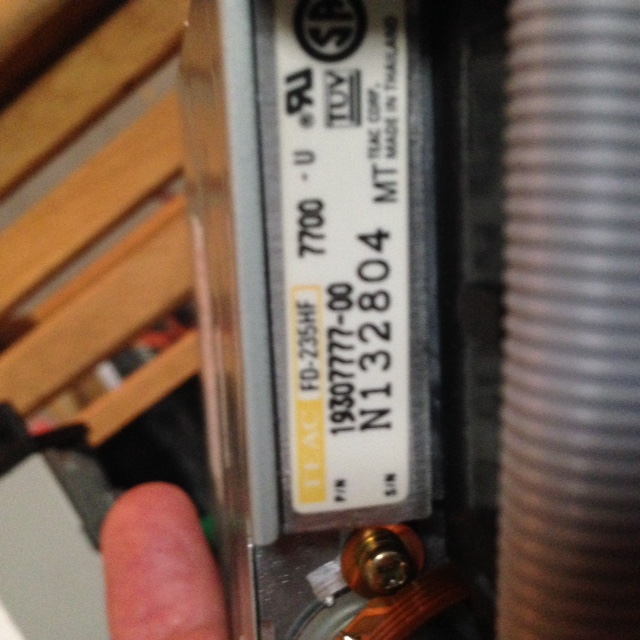

Teac FD-235HF 1.44MB
Would like to make this work for the SSL Solid State Logic 4k console computer.
I'm not a tech so I don't know what info Jeff needs.

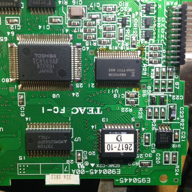

Hey Jeff just seeing this. Codes on bottom of controller card below:
TEAC FC1
2617-10 That's on one of the chips white sticker
E950445- on pcb
E900445-00A- on PCB

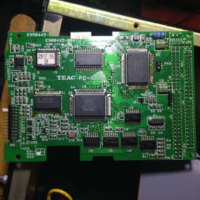

controller pics
