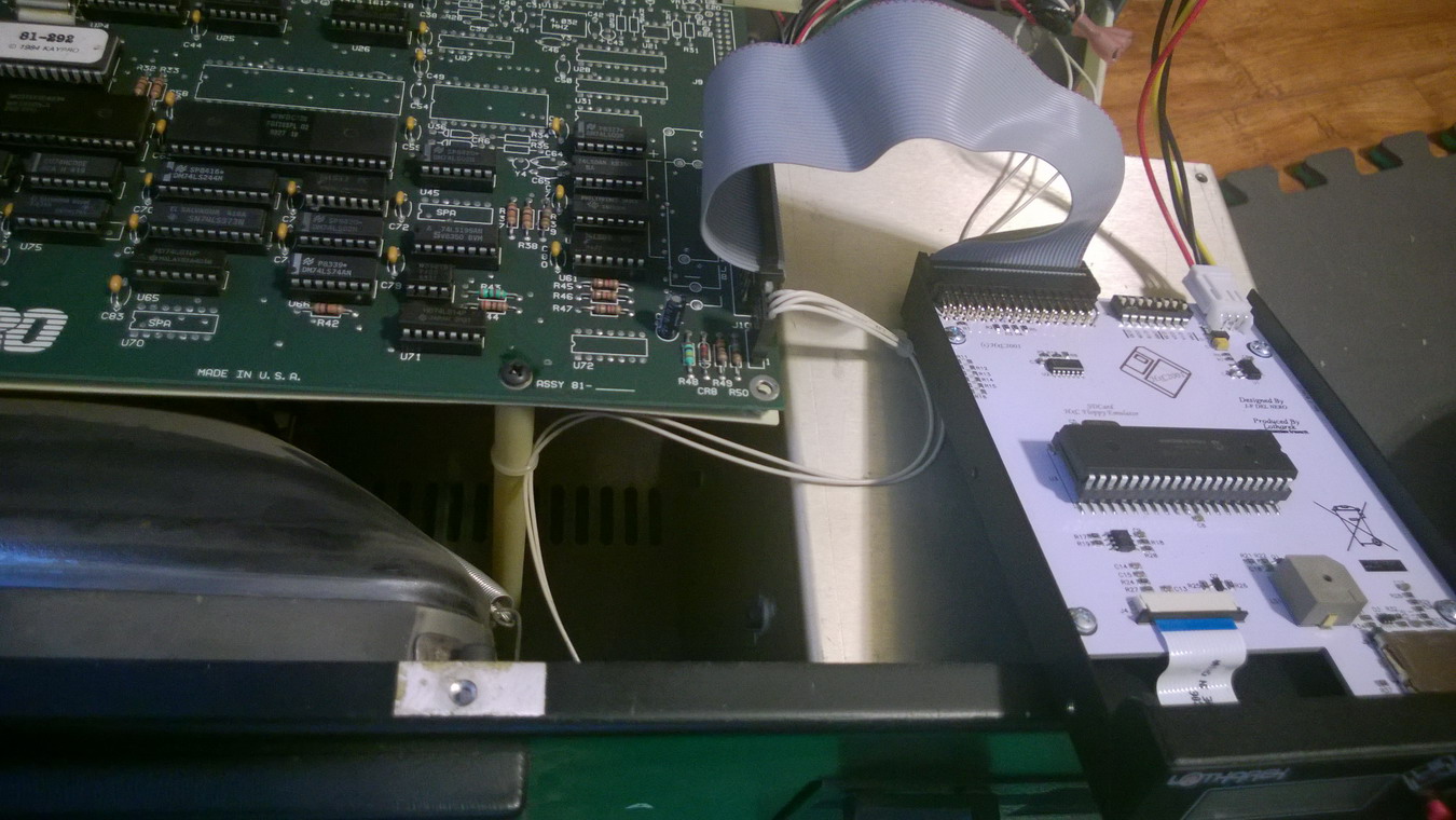

Hi everyone– I have my brand new Lotharek REV FB - BLACK and I am trying to connect it to my Kaypro 2.... (pictures below)

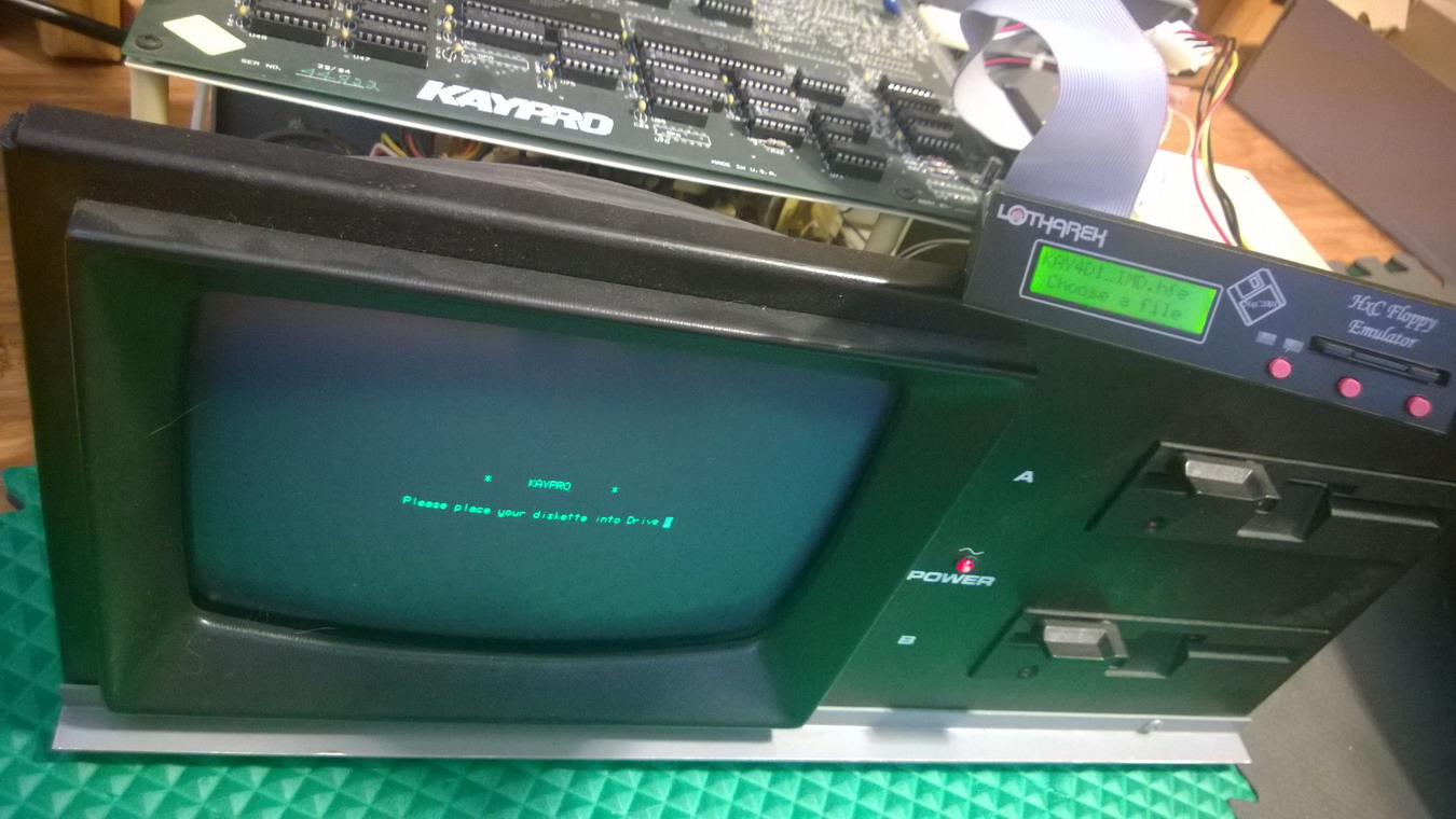

I switched on my Kaypro with the cable connected (no twist) to the HxC.
My CRT says:
* KAYPRO *
Please place your diskette in Drive A
The HxC is powered up correctly and gives me the option to:
Choose a file
"KAY4D1_IMD.hfe"
My HxC beeps when I select but the Kaypro does not boot (or attempt to.)

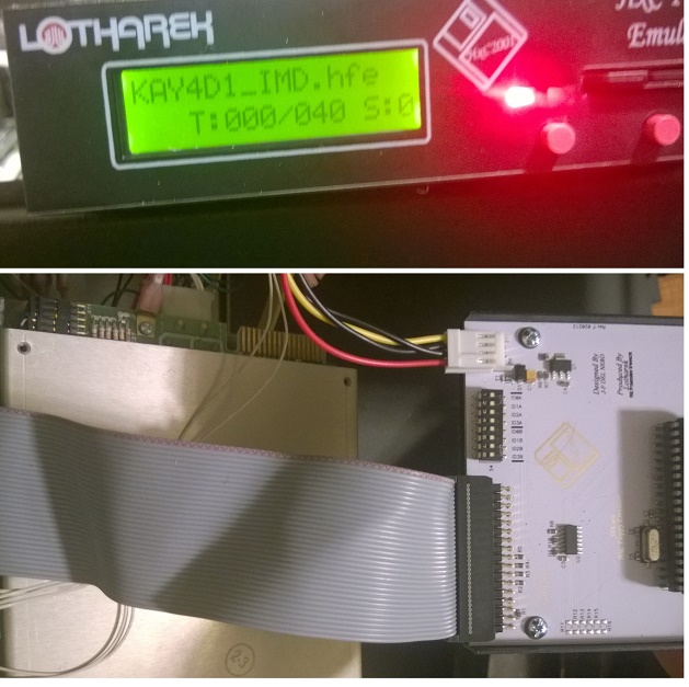

My HxC is connected to the Kaypro by straight ribbon cable (no twist) and it displays "KAY4D1_IMD.hfe T:000/040 S:0"
when I select the file using the middle button (see pic) .... nothing seems to happen on the kaypro (no signing of booting or anything else)

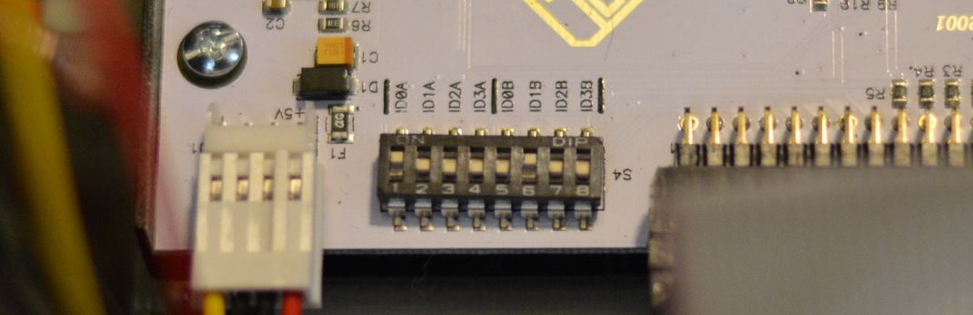

Please set the ID0-A (1) and ID1-B (6) switches to ON.
hails
Posts: 26
Joined: Thu Jul 21, 2016 5:00 pm
Re: Kaypro 2 (shugart?) attempted boot
Post by hails »
Jeff wrote:Please set the ID0-A (1) and ID1-B (6) switches to ON.
Hi Jeff- thanks for the suggestion. I changed the jumpers but same symptoms (nothing seems to be going on)
Hailey

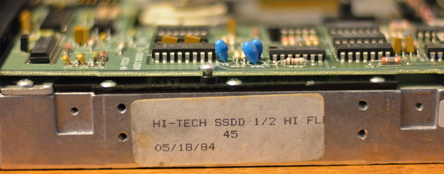

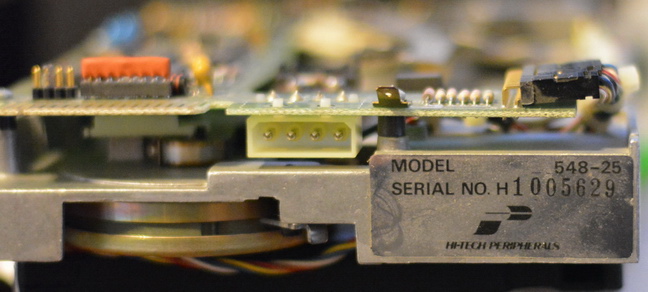

Hello... Thought I'd best crack open the box a little further and verify the drives.... are these "Hi-tech" SSDDs Shugart-equivalent?
Model Capacity Size Media Type Height
Hi-Tech 548-25 180K 5.25" Single Sided, Double Density Half
"Hi-Tech Peripherals"
Does it matter to the HxC settings? 8)
