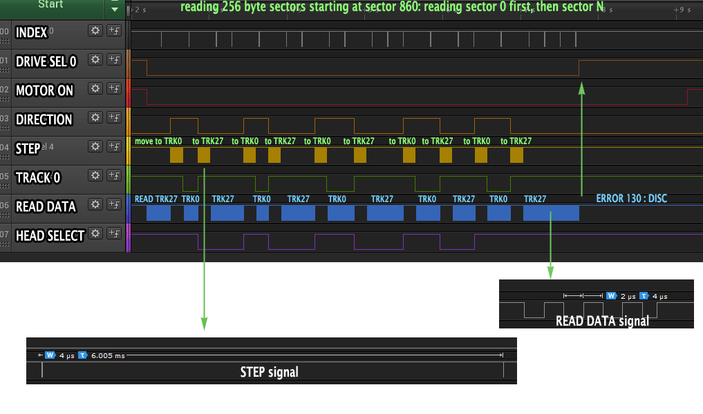

in the meantime I obtained a SanDisk Extreme Card (16 GB, 90 MB/S read speed, U3 write speed, Class 10, UHS-I). The keyword seems to be U3 for recording speed.

I also hooked a 8 channel logic analyzer to the signals.
Looking at the signals does not show me anything special (but this means nothing).
Only the reading attempt of the last sector on track 27 is very long, compared to the previous reads.

- I then wrote a small BASIC program reading complete 256 byte sectors in a sequence from logical sector 0 to 1199 over the complete disk.
This needs no Volume or directoy information. It worked without problem, so the image is completely readable. - Then the program was modified to force the HxC emulator to seek for each sector.
A reading of sector 0 was inserted just before reading the desired sector. Thus the emulator had to seek to sector 0, read it, and then seek to the desired sector and then read this sector. - This procedure worked up to about cylinder 27 was reached. Then it failed.
Some timings
- Index pulse duration 4 ms, interval 0.195s which corresponds to a speed of 308 1/min, which is very slightly out of the 300 ± 1.5% band
- Read data bits duration 2 μs
- Head step pulse duration 4 μs (o.k > 200 ns)

Re: Replacing Tandon TM-100-2A in HP 9130 disk drive for HP
Please share the HFE files : the formatted one and the pre-formatted with the write attempt.
(Is the double step needed by your system ?)

CAT - show directory
- T:000/35 S:0 head moves to cylinder 0
- directory is read from sectors 3 up and displayed. O.K., as before
LOAD "Autost" - try to load a file
- T:016/35 S:1 head moves forward, but only to cylinder 16
- should move to cylinder 32 where "Autost" begins
- track change sounds like a continuous beep (fast pulses) - ERROR 130 : DISC
- T:000/35 S:1 head moves back to cylinder 0
- track change sounds like single beeps (slower pulses) - ERROR 130 : DISC
DSKA0000.hfe: errors at sector 576, track 17 (seeks very slow, bip-bip-...)
DSKA0001.hfe: errors at sector 588, track 18 (sometimes +/- a few sectors)
DSKA0002.hfe: errors at sector 867, track 27 (seeks very fast, short beep)
The first HFE file is the one you provided, the other two are the same that I had sent in the previous ZIP file.
So the new DSKA0000.hfe file seems to have a problem when it shall seek further than approximately 16-17 cylinders. I have not yet tried to seek e.g. from cylinder 10 to 27+ to see whether the seek distance also makes the same problem when jumping between higher cylinder numbers.
The file DSKA0002.hfe seems to be better, but not good enough: is can seek up to 27 tracks.
So my interpretation is that the seek takes too long.
On the other hand the real floppy disk is rather slow, so I am not sure what is going on.
Martin

I also changed my test program to jump back not to sector zero but to a higher sector number
to see whether this shifted the possible cylinder range to higher values.
The results using DISKA0001.hfe are
starting at sector 000 = from cylinder 00 to 18 then error, delta = +/- 18
starting at sector 300 = from cylinder 09 to 18 then error, delta = +/- 9
starting at sector 400 = from cylinder 12 to 24 then error, delta = +/- 12
starting at sector 500 = from cylinder 15 to 25 then error, delta = +/- 10
The number of cylinders that can be skipped without error is not constant and varies between 9 and 18 cylinders.
When I seek from a higher starting cylinder errors occur a bit later, but the range of cylinders which can be skipped does never increase. Sometimes it is much lower than 18.
Martin
So forget the last HFE. This mean than you don't the double step with this machine.
I just send 2 new hfe to try.
