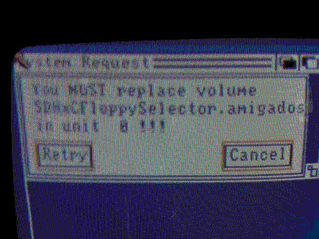

i have problems getting the Gotek (HxC Firmware) with I2C Display to work connected to an Amiga 500. The Gotek connected to a CPC464 is working without any problem.
I have tried several USB Sticks (FAT32), copied the cfg and the autoboot.hfe files then some adfs, but either the Amiga doesnt recognize the autoboot or it loads the autoboot.hfe until the amiga displays the message attached. Sometimes after pressing the switch connected to the "JA" Pins it loads the autoboot and its possible to place adfs to the slots, after saving and rebooting a similar problem occurs with a game adf, sometime it loads completely, sometimes it only trys to load, 2 or 3 tracks as shown on the I2C Display. Does anyone have an idea?

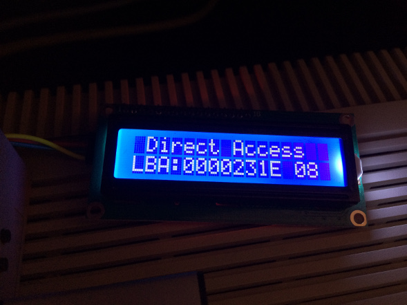

If i start the Amiga the Gotek i can choose the ADF Files, the Floppy LED lights up, as you can see on the picture T counts from 000 to 002 but nothing happens.
If i then press the Button connected to "JA" Pins, reset the Amiga, and press the Button again just before the Floppy LED lights up, the ADF loads until this message appears.
If i then press the button again and choose "Retry" it goes on loading the file. I repeat this 2-3 times until the game is loaded.

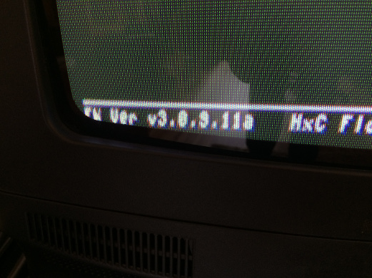

I have made a video that shows the behavior.
https://youtu.be/83VDLlHuVC8
Sometimes it loads (using the "JA" button) until the Startscreen of the Autoboot Software and then hangs up, as you can see in the video.
Sometimes it works and it shows the FW Version as you can see in the following pictures.
