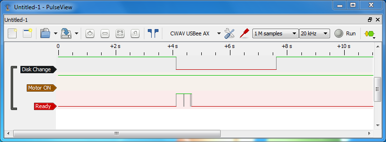

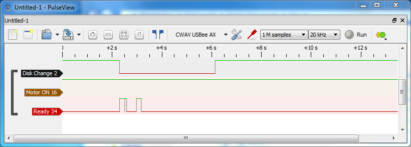

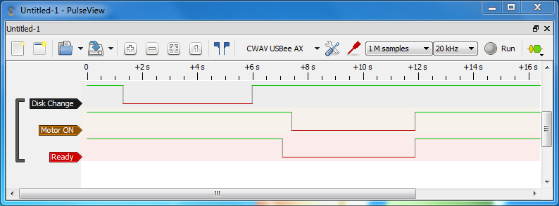

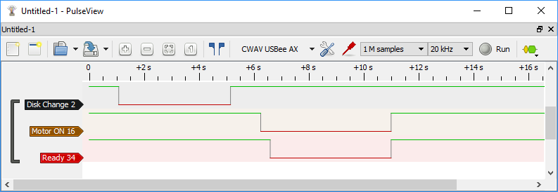

The hardware connection is:
So far, so good, but unfortunately the HP1652B does not recognize a disk change.
The Disk Change signal is pulled down (activ) for about 4-5 seconds if you select a different .hfe file.
If I change the floppy disk file with the Gotec front push button, the HP1652B tells me: No Disk.
This is still an open question, because I need a Data Disk to store Configuration Data,
and an Inverse Assembler for GPIB decoding.
Regards, Rudolf

Re: HP1652B floppy disk drive emulator can not load SYSTEM_
Hello Jeff,
in order to have some solid signals to talk about, I recorded
the Signals from the 34 pin floppy disk plug:
1. Disk change, pin 2
2. Motor ON, pin 16
3. Ready, pin 34
while a disk change.
The signal Drive Select 0 was LOW all the time, in both cases.
You see at the diagram Disk_Change_Sony_FD.PNG:
1. Disk change goes LOW if the disk is removed, and
2. Disk change goes HIGH when a disk is inserted.
3. When I give the command show directory,
the motor starts and Ready goes LOW (active).
4. After that operation the motor is switched OFF, and Ready goes HIGH.
That seems logical for me.
The Sony floppy disk manual (1985) tells about the READY signal:
The line is TRUE (low) when all of the following conditions are met:
a. The drive is selected (always ON)
b. A disk is inserted. (I think, if Disk change is HIGH)
c. The Motor ON signal is TRUE (low), and
d. The index period of the motor settles within 200 ms+/- 2.5%
( I think it must be 100 ms at 600 RPM)
Your see at the diagram Disk_Change_HxC_Shugart.PNG:
1. The disk change signal is very similar to the Sony FD.
2. The motor signal is always OFF. Why?
3. The drive signals Ready LOW (active) while the disk change is not finished.
That seems not so logical for me.
I assume, that the HP1652B is confused by the HxC Ready signal,
and does not assert Motor ON.
Because it does not come, no Disk change is seen.
Before I test all the different Interface Settings, do you have in the
Interface Settings something which is similar to the Sony FD behavior?
Regards, Rudolf
I don't understand the sony chronograph : ready is coming before the motor on signal, which sound odd to me. Are you sure that the signal labels are correct ?
Hello Jeff,Jeff wrote:I don't understand the sony chronograph : ready is coming before the motor on signal, which sound odd to me. Are you sure that the signal labels are correct ?
You are right, it was a mistake from me to swap the 2 signals.
Please see 2 new measurements, the situation did not change.
Regards, Rudolf
- Disk_Change_Sony_FD2.PNG (17.26 KiB) Viewed 52488 times
- Disk_Change_HxC_Shugart2.PNG (66.58 KiB) Viewed 52488 times
Sorry for the very long response delay, it seems that i have forgotten this thread...
Anyway after reading again the thread, i almost sure that the disk change don't work because you have used the Motor-on signal to select the emulator.
You must use the DS0 / Drive select line.
No need to open the machine to fix this, you can use the "Not Gated" firmware version available into the archive :
(With this firmware the drive is always "selected" and the drive selection line is ignored)
Once updated, set interface mode to "custom" and use the Disk "nDiskChange 1" mode for the disk change pin.
