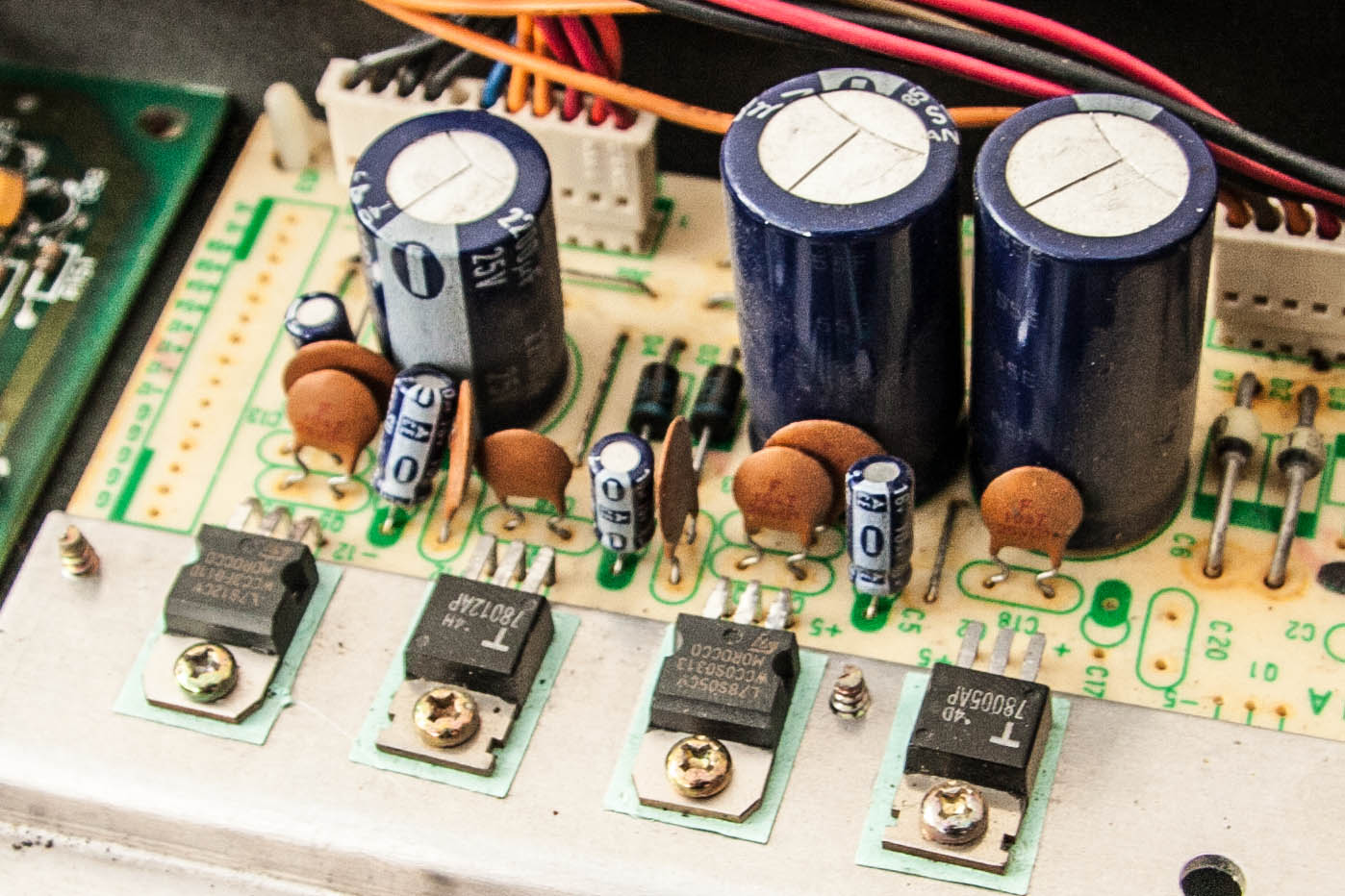

First thing I would do is check the voltages from the Mirage power supply. Crazy things happen when you've got wonky power, so I'd eliminate that first. It could have something to do with the real floppy drawing off the 12V maybe because the Gotek only uses the 5V line.
If you've got a multi-meter and know how to check voltages, the 4-pin harness on the power supply should carry +5VDC and +12VDC and the 6-pin harness closest to the 4-pin harness should carry -12VDC. The other harness leading to the transformer is all AC, so I'd avoid probing that.

+12v -12v and both 5v 78XX series regulator voltages are correct and stable, sorry reading back my posts I didnt make clear what I meant about the standard floppy drive working quickly. I dont have any means to write the "EDM" file to floppy to boot the Mirage however when using a standard FDD, disk activity is very quick indeed unlike the Gotek.

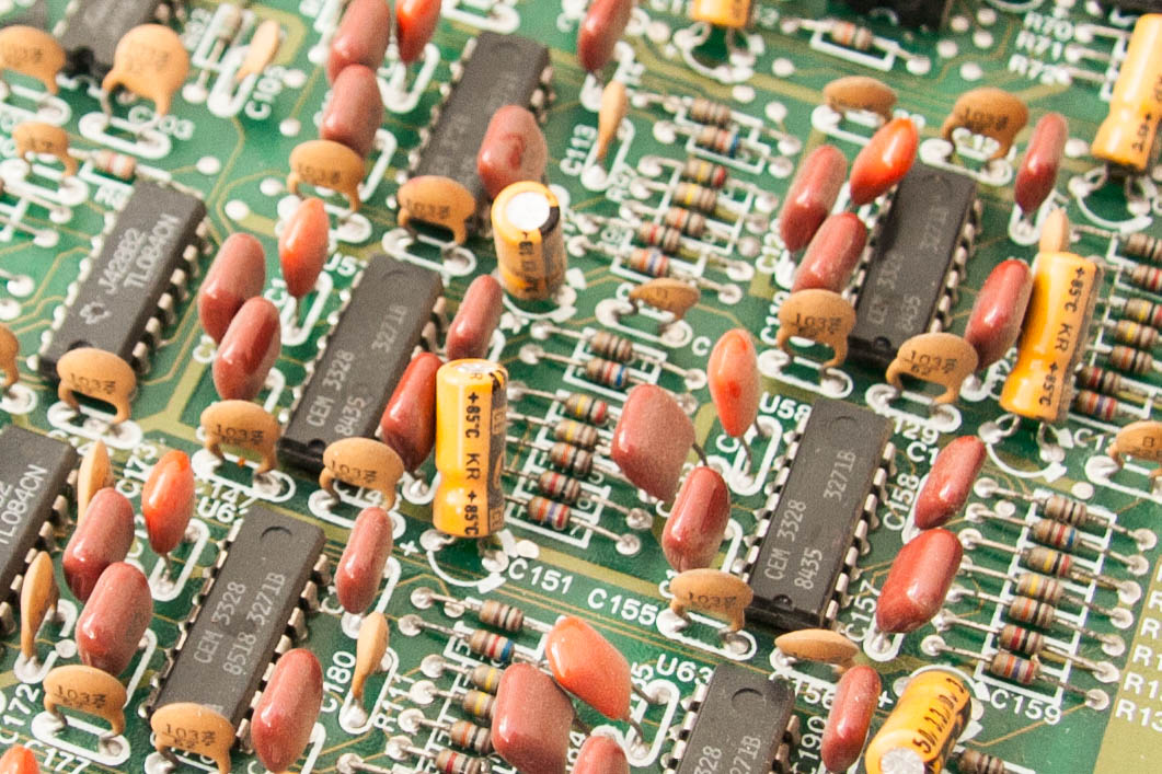

Have you reseated the CEM3328 chips? Does anything look weird with the capacitors beside them?
Re: Ensoniq Mirage with Gotek possible issues.
Hi Mondo1976,
Thanks I understand your opinion and you do make a good point, but without access to an image of the OS I can write to floppy Ive been looking at it from the perspective of communication between the FDD and Mirage vs the Gotek communication.
Attached are some shots, its grubby and needs TLC.
RE: filter section, apart from dust the polyester caps appear undamaged and electrolytics look in good order for thirty odd year old caps, no sign of bulging, stretched jackets, leaks etc. The legs on the IC's are a little dull but not heavily oxidised. The trimmer in the filter section also looks like its remained untouched
regards
regards

I guess you can't reseat them since they aren't even socketed in this particular circumstance. I'm out of ideas for the time being, personally.
