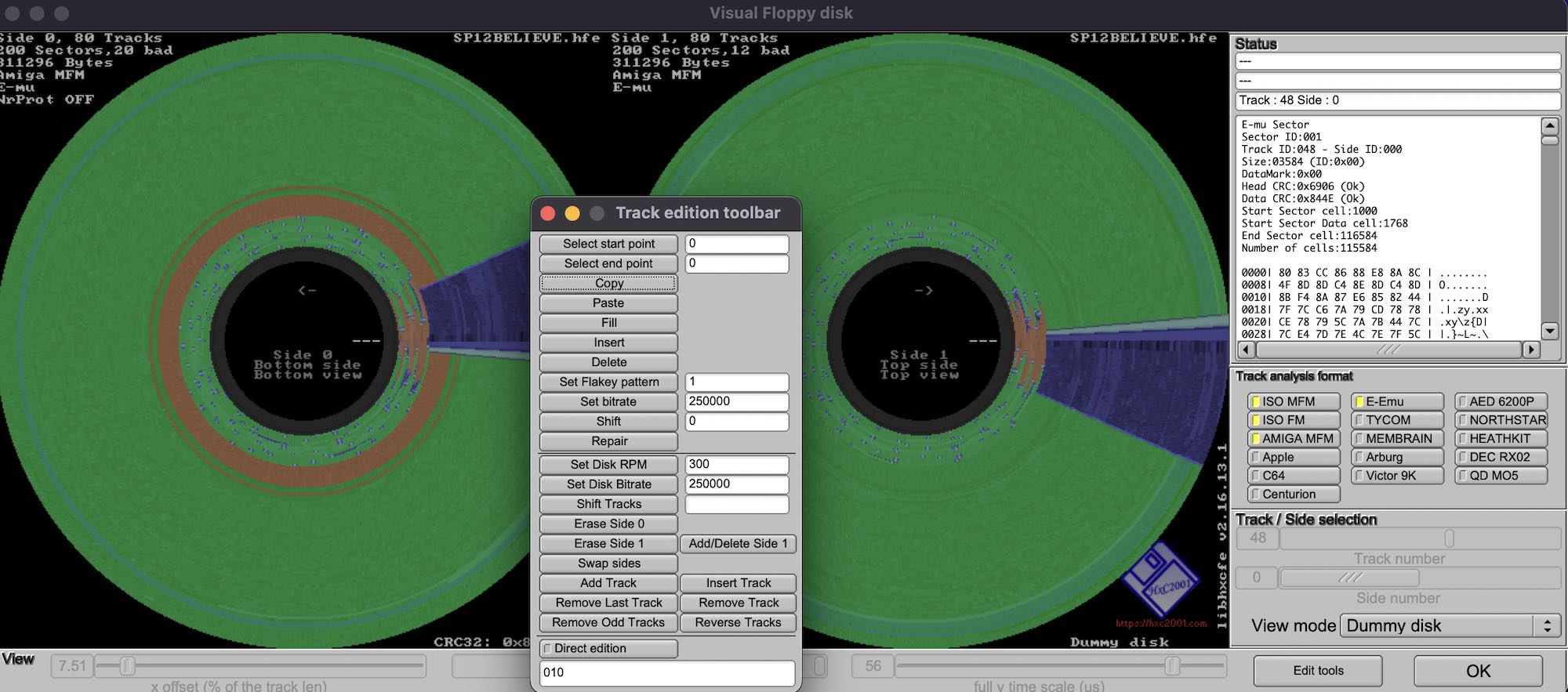

Re: USB Floppy drive to transfer SP1200 disks
Hi , its been a while since i've experimented
with attempts to copy my EMU SP1200 floppy images to .HFE
here are the screenshots from a floppy converted with Greasewheazle 4.1
using this command :
gw read --dd L --drive=b --tracks="c=0-79:h=0-1" SP12FLOPPY.scp::disktype=other-720k --revs=1 --adjust-speed=312
than i converted the raw file to .HFE with HxC ,
the resulted .HFE loaded all samples but one sample has a playback glitch in it .
the track analysis shows 12 bad sectors on one side and 11 on the other
how to read understand track analysis and how to use edit tools - is it even possible to repaid bad sectors ,
where do i go from here?
The main issue is that you have made the dump with one revolution only. Please retry with "--revs=3"jazzroom wrote: Wed Aug 19, 2026 10:35 pm Hi , its been a while since i've experimented

Second point : Would be nice if you can share the scp files to have a definitive advice about the issue.
EDIT : After another look to your screenshot it seems that this disk has some others format issues : i see some Amiga tracks at the end ?!
There is maybe less track impacted since the the SP1200 don't use all cylinders.
You can try to tweak the hxc software pll parameters, but to be sure about the real issue please share the SCP stream or show the stream view of a bad track.
