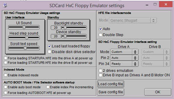

Hi!
Can someone tell me the correct settings?
My HxC2001 module seems to be very slow and does not access Full Dumps with 2 Disks.
Best Regards,
Kubi

Kubi wrote:SOLVED!!!! :D
OK, so I had my HxC up and running in my TS-12 and decided to move it into my FZ-1. I created 2 raw images on the 16 GB SDHC that I have and replaced the config file with settings identical to the ones above. When I go to format the disk from the FZ-1, it keeps giving me a "disk protected" error message. Any advice would be appreciated! Thanks.

can you read the image ?
Yes, the Lotharek itself reads the raw image(s) and I just verified that it's updated to v1.8.2.40. In the HxC software I created the images using the predefined Casio FZ-1 layout as well. However, the FZ-1 still gives me the "DISK PROTECTED" error whenever I try to format the raw image or save. I also went back and completely wiped/formatted the SD card just to be sure it wasn't something lingering from the TS-12, but this did not make any difference. I tried some of the Casio FZ-1 sound sets that people have shared on here, but when I try to load the banks, the FZ-1 says "LOADING" but then stays like that forever and freezes. It seems like there are a few other threads on here about the FZ-1 (which I have read through before even posting here) and people seem to be getting mixed results. If anybody else would be willing to share their config for their FZ-1 it would be nice, or if there are other bits of troubleshooting I can try, that would be great as well. Thanks!

Post by Camphor »
I've been looking through some other threads, and was encouraged when I saw that there's an option in the menu to bypass write protection. I went in and selected ""WR enabled" and no luck. I've triple-checked that the write protect switch on my SD card is not selected, feeling very confused and discouraged now. :cry:
Re: Settings FZ1/FZ10M
Can you read the image with the Casio ? Can you load something from the disk ?
I have the feeling that the floppy ribbon is not connected to the right way, so please confirm or not that you can read the image with the Casio.
