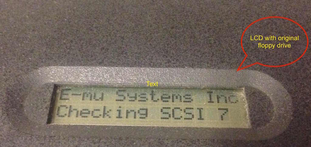

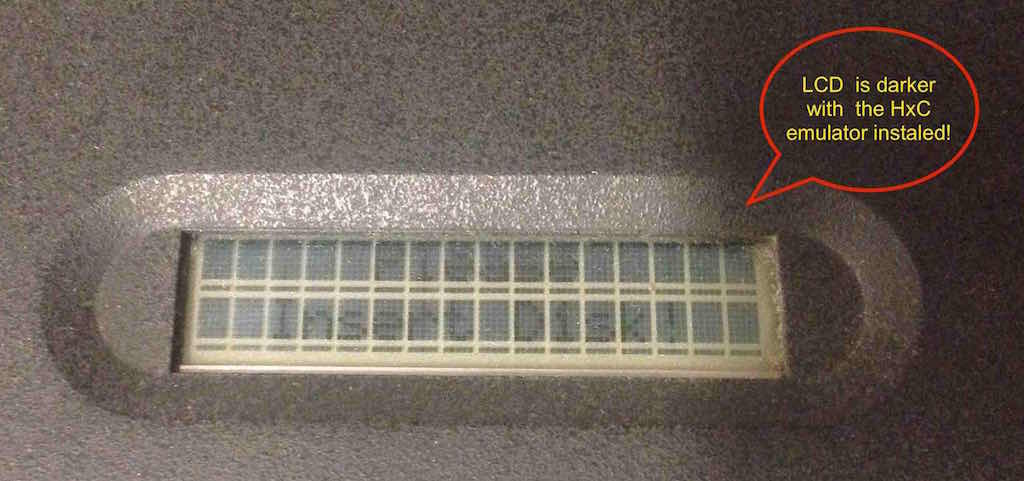

I recently had the chance to install a HXC Rev F on my eMax II keyboard and I have the following issues!
1 - My Hxc emulator 'somehow' draws too much current from the power supply causing the AZ830-2C-5DSE relay on the main PCB board making an odd buzzing noise for a few second when the unit turns on and the LCD turns a bit darker (low contrast) which make it hard to read. I have to turn the unit on & off a few times to by pass the noise however the LCD still remains dark. When I install the original floppy drive on to the unit, everything is normal! No noise and LCD’s contrast is Ok.

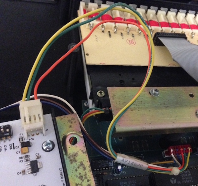

Please put some pictures of your connections to the HxC.
I am almost sure that you are feeding it with +12V....
Re: EmaxII makes noise with HXC & does not boot the OS. HELP
There is only one way to connect the connector to the HxC!
The +12v is connecting to the 'unused pin' according to the HxC schematic.
The voltage across the floppy drive's power cable has been +5 before/ and after recapping the PSU.
I'm almost sure that the HxC draws too much current from the PSU which cause the LCD dims. Again the LCD is totally fine with the original floppy drive!
Jeff wrote:Please put some pictures of your connections to the HxC.
Hi Jeff, Did you get a chance to see the photo of the connection? Thanks
What is the voltage on this yellow wire ? please measure it.
