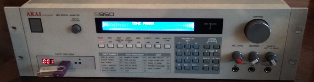

MatthewleBlom
Posts: 14
Joined: Sun Mar 06, 2016 10:39 am
Re: S950 + Gotek HXC
Post by MatthewleBlom »
Just a pic :)
